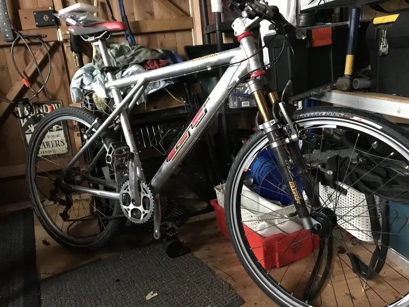

So why the unconventional ‘standard’ setup?View attachment 559624
With the brakes at the rear it stops flex of the arms, in theory creating more power. On the front of the fork when the brake is applied the rim directional force pulls the brake around, behind it pushes the brake onto the fork creating a stiffer brake. Same at the rear, the brake is pushing onto the stays.

Finished neighbours bike. Absolute pain and I’m not happy with it but she will be. Xt v pivots are really sloppy. Forks squelch. Bearings grumble. Rear mech shot. Replacement had bits missing. Saddle torn. Seat clamp missing so she forced on a smaller one. She’s attempted to fix it herself and made things far worse. £40 in parts from me. Plus a good few hours. She has others but I’ll politely decline thanking her for reminding me why I do this as a hobby for myself only.
