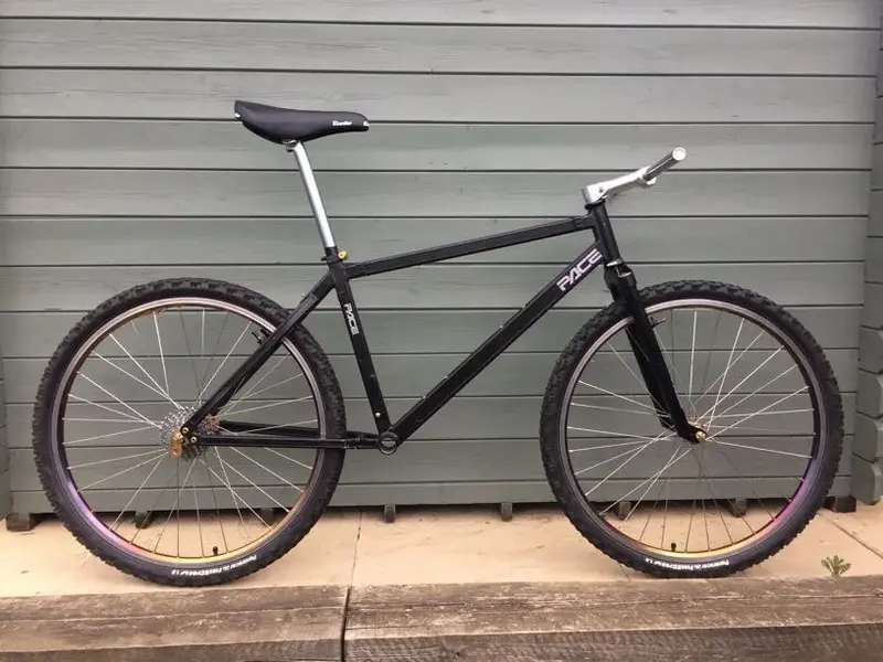

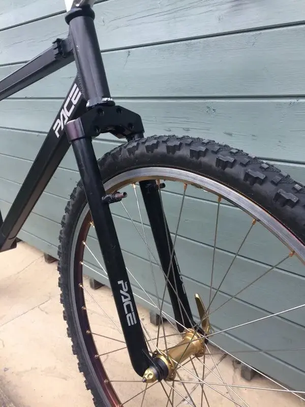

Here are the forks from dnbmatt28
It’s on the gold M737 / 217 Sunset Tim’s I have for sale but that is all set to change with the next post.....
Also the seatpost it came with and the Turbo saddle from minifreaks Yo. Both also set to change imminently.

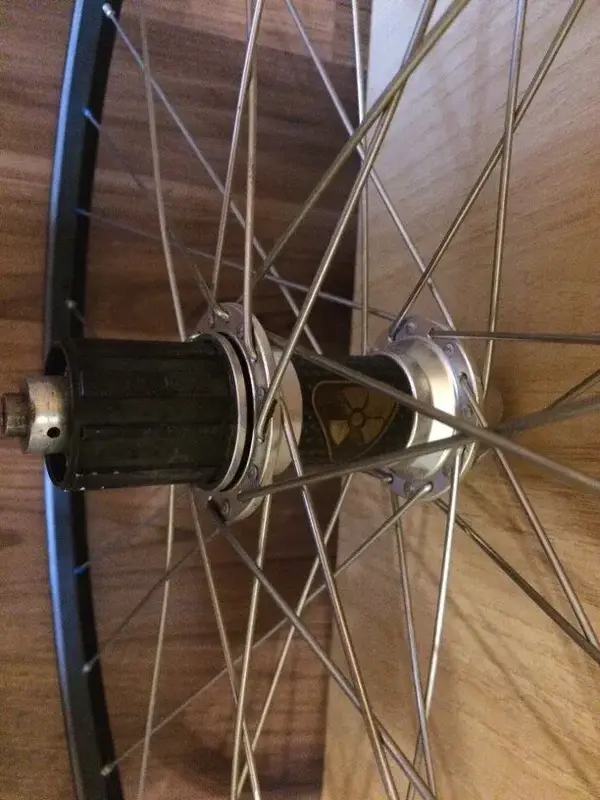

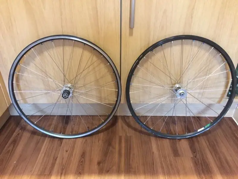

And here are the new wheels, courtesy of Viengsavsnh
They are in great nick. It’s a real shame the anodising has come off the rear braking surface. Now need to decide, do I find an even better black Stheno, or another polished silver one to match the NOS one I already have? Either way a wheel rebuild is in order because the hub decal is not directly below the valve hole and the spoke lacing in the front is not the same as was done on a previous build so there are some spoke marking on the hub flange
Overall super pleased with these. Exactly as described in the listing.

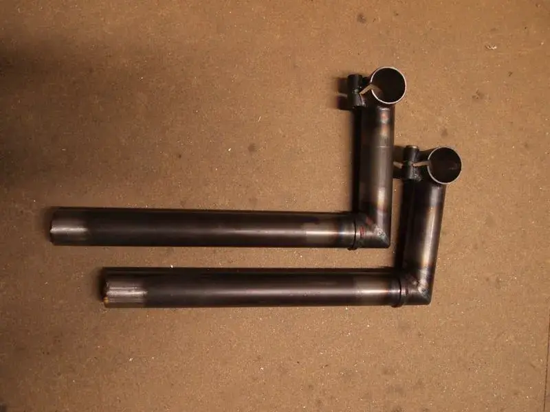

And, very long shot, a 1-piece Pace Stem-steerer. Even if not for sale, I’d love to borrow it to see what it looks like and get a replica made - a suitable deposit would be supplied!
I have made several replicas for people in these parts...PM if interested.
