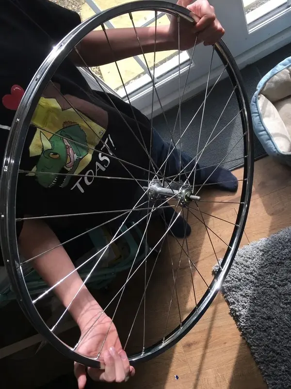

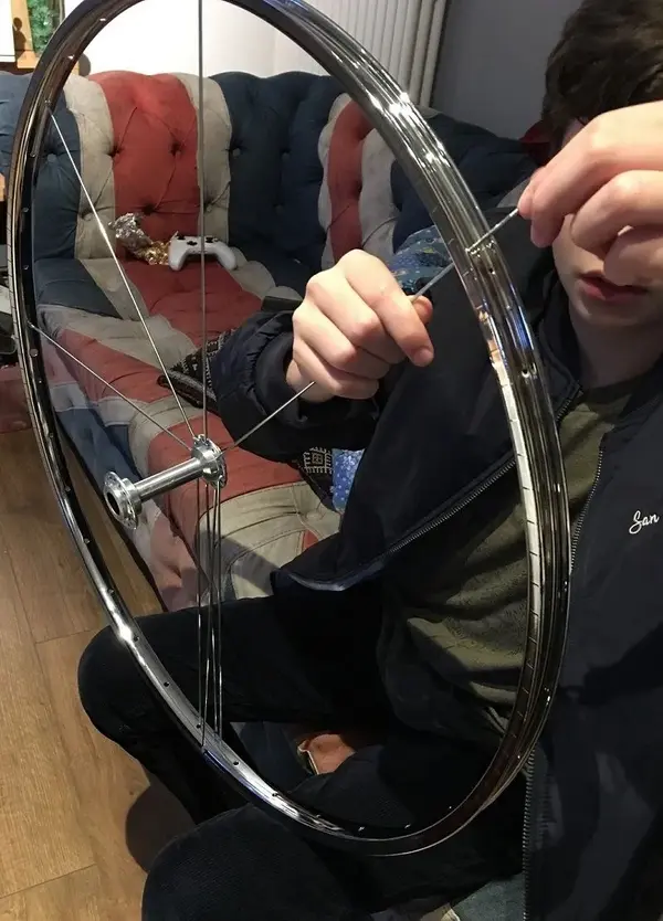

Nothing confusing about it, its childs play... go on, jump in.....you will wonder what on earth you were worried about. :lol:
Cue photos of my children building wheels..... :wink:
