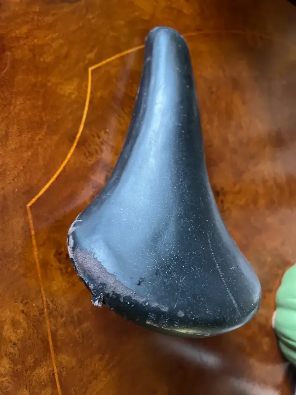

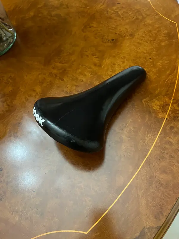

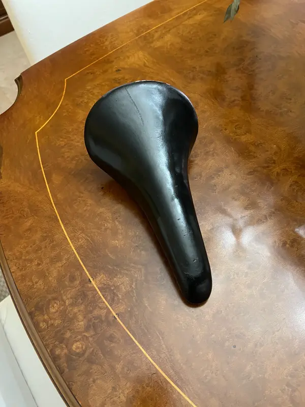

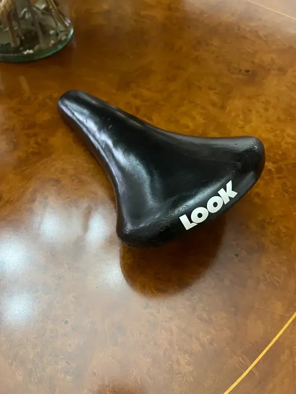

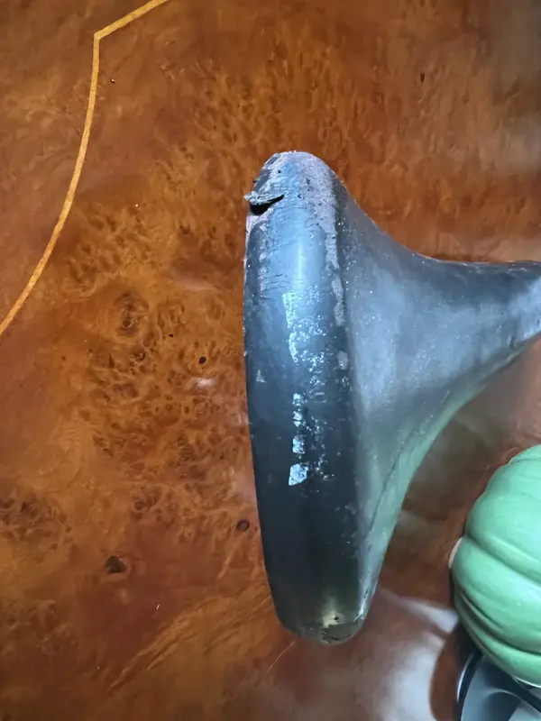

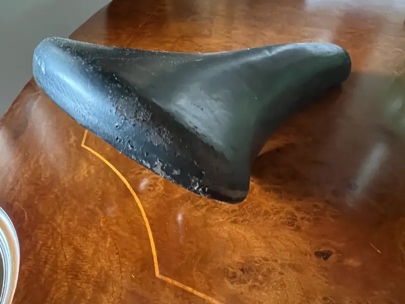

I've just restored a Look saddle made by San Marco. I didn't reupholster it like I did with the white Avocet; I only restored the leather. I like those "marks" of use—they tell stories of countless cycling adventures.
The logo had to have 13 mm letter height, and the length is proportional; it wasn't retouched. In this case, the logo could still be measured with calipers, which is very good.
Again, I used UV DTF, but it's the most practical for these restorations. I found the logo on "Seeklogo"

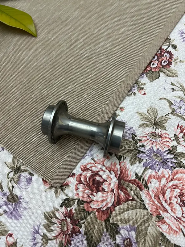

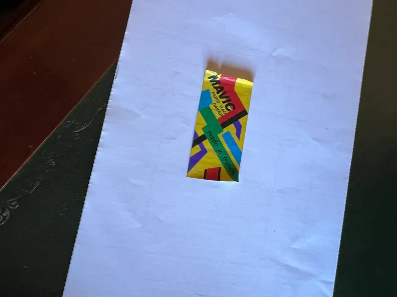

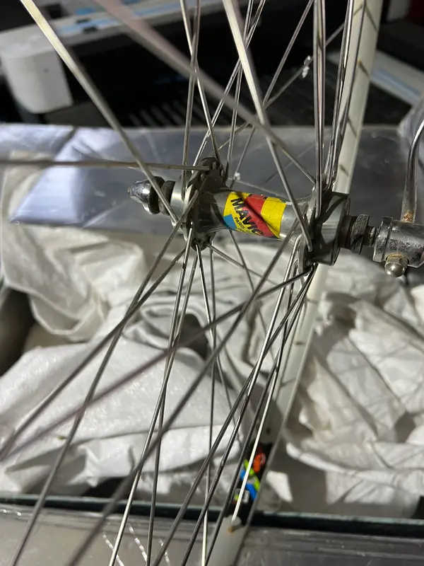

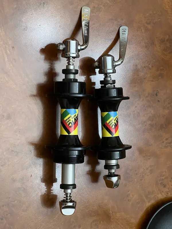

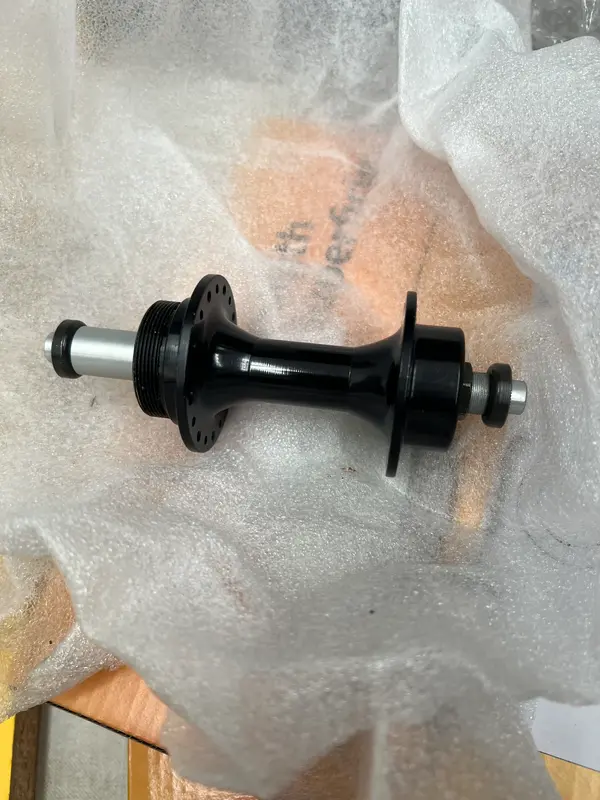

Here I used a system similar to the one you want to use with Ringle:
I found a NOS Paris-Gao-Dakar rear hub, but without the original decal.
Then a front hub in good condition appeared with the decal still clearly visible. With care and oil, I was able to peel it off intact.
Then we scanned and vectorized it.
Now I have a beautiful set of Paris-Gao-Dakar hubs.
In this case, the important thing was the length of the decal, since the space is the hub's cylinder.

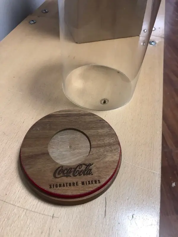

And the final points:
The engraving depth can be adjusted, but it's trial and error. The best thing to do is bring an aluminum plate and test different intensities.
On the Ringle lid, I used a low-power fiber laser, and that was enough. But with other materials, you have to do tests before deciding which intensity is correct, so that it's well engraved and doesn't burn.
I have photos of other jobs (not bicycles) where I keep this data. Let's see if I can find a wood engraving job for Fever Tree on the server; I need a lot of tests.
The Coca-Cola engraving on wood took me about seven attempts to get the best result.

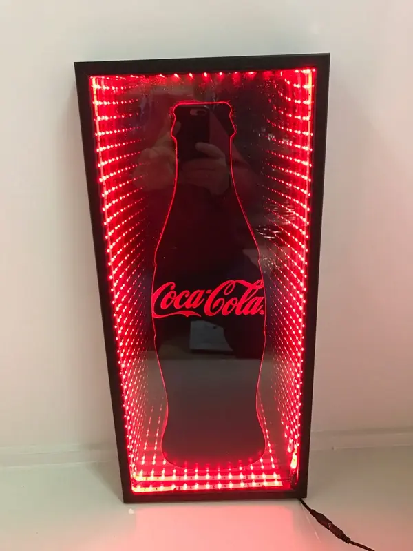

The good thing about lasers is that they can engrave on anodized surfaces, paint, etc. I'm also attaching an image of Coca-Cola laser-engraved over black screen printing. In this case, the engraving was necessary to "etch" the methacrylate and make it light up.
