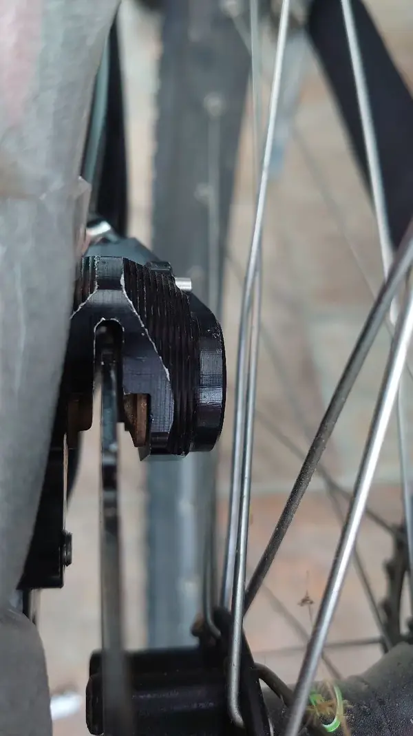

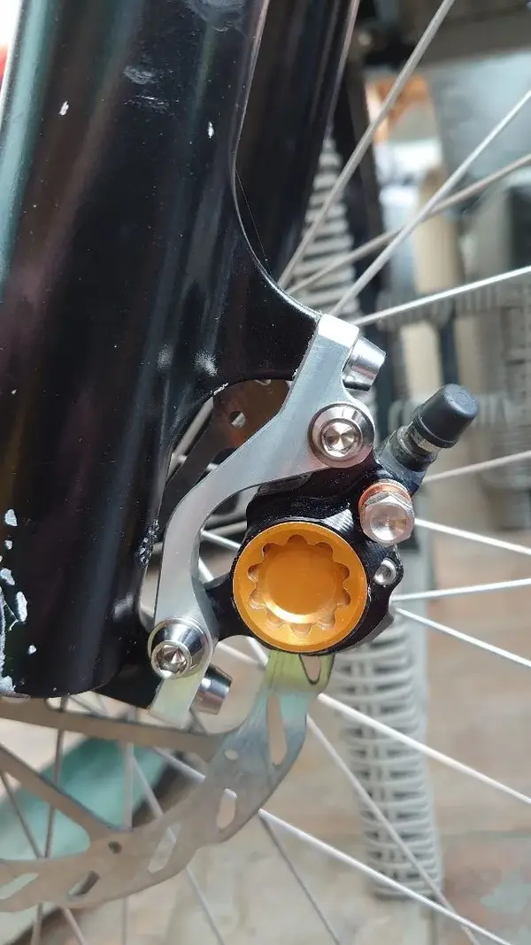

I also collected a set of brakes today that came with a no 5 caliper so now I can have 180mm front 160 rear. Just waiting for a new banjo bolt so I can connect it all up and bleed them. Only problem I have now is that the rear 160 disc looks a little small for the position of the caliper, probably something to do with the adapter, so now on the look out for a 165mm but these seem rare.

Went to bleed the brakes yesterday, the front one went OK but the back one is putting up a fight. First off the bolt for the reservoir wouldn't come out so swapped the leaver out for another one. That reservoir was full of green sludge so tried to flush it though and it started coming out the bore cap. I'm hoping it will only need a replacement o ring on the bore cap as I'm not overly confident at rebuilding the caliper.

Today I was trying to get the back brake bled and it's been kicking my ass!
First off I needed to change the O-ring seal in the bore cap as it was leaking fluid from there. The old o-ring looked like it was installed incorrectly as it was pinched on one side but fine on the other.
Once that was done I went to bleed the brake but the lever just wouldn't firm up. I tried regular bleed method and reverse bleed but the result was the same.
I was just about to chuck in the towel and get a bike shop to do it but decided to watch some tutorials fon YouTube first. I learnt nothing new but in one of the comments was a hint at what I was doing wrong. It said to make sure the nipple points up.
On my frame the nipple is pointing down so took the caliper off and bled the brake with the nipple up and loads of air came out. With the nipple down there must've been some air trapped in the corner of the pistons. The lever is now nice and firm.

Since the last post I changed the from PM to IS adapter to a black one, got a 165mm disc for the rear and got an MRP G2SL chain device.
What I'm still going to do is change the rear disc, the current one is a Grimeca 165 and it's a bit thick and looks rubbish, I have a hope one on the way. I'm going to rebuild the rear caliper as it's a bit spongy and I think the seals are weeping fluid and I'll also adjust the hose/cable lengths as they're a bit long.
