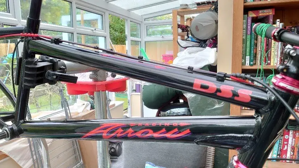

Couldn't wait any longer, I've taken the protection off the frame.......mainly to put some helitape on. I have also put the head badge on.

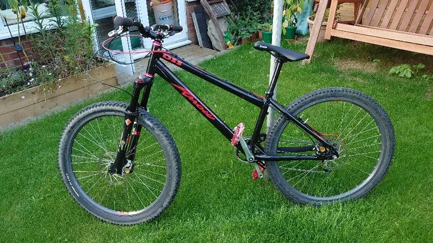

The build is coming along.
Gears have been set up, front brake has been bled, rear caliper needs a rebuild and need to get chain device set up.
The forks feel horrendous, but they do need a service as they're leaking a bit of oil.

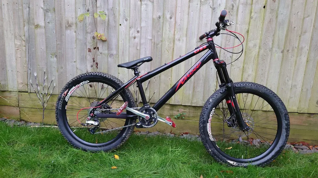

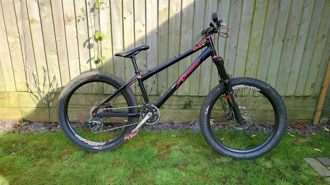

The Arrow DSS build is pretty much complete.
The wheels were built by BRINK and forks just arrived back from a service at Pace. And I got some second hand wheels for £30 that came with DMR Motodigger tyres which are perfect for this bike.
Since the last post I changed the from PM to IS adapter to a black one, got a 165mm disc for the rear and got an MRP G2SL chain device.
What I'm still going to do is change the rear disc, the current one is a Grimeca 165 and it's a bit thick and looks rubbish, I have a hope one on the way. I'm going to rebuild the rear caliper as it's a bit spongy and I think the seals are weeping fluid and I'll also adjust the hose/cable lengths as they're a bit long.

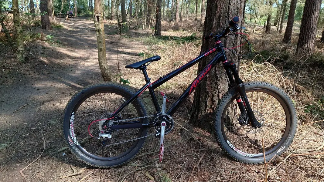

A few weeks ago I went to the local bike park on the Arrow and it performed really well. The only problem was the back brake mount appeared to move and needed to be adjusted a couple of times. I even had a few compliments on my bike from other riders, which was nice.
When I got home I finally decided to fix the length of the cables, which was less hassle that I was expecting as the brakes needed minimal bleeding afterwards. I was also very bored on eBay one day and bought an XTR M952 rear mech so put that on while I was adjusting the cable.
