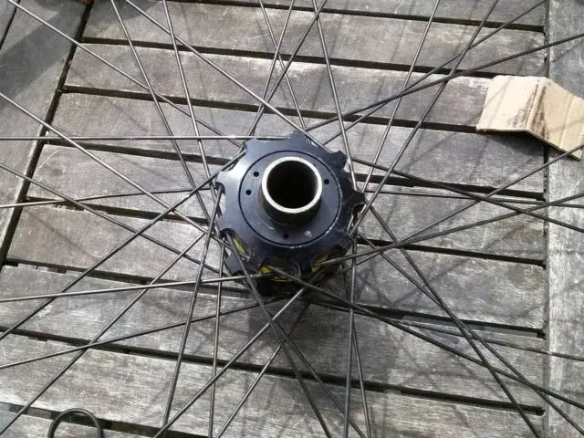

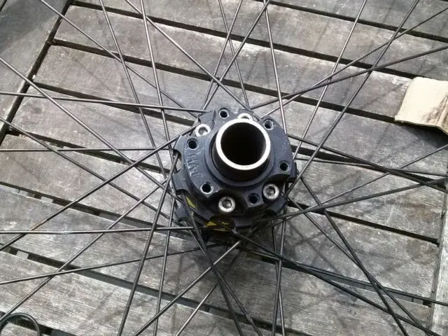

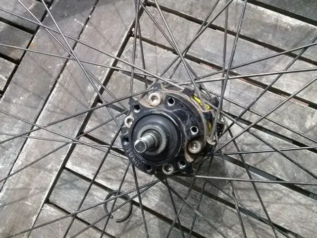

Basically looking to change 20 MM axle to 15mm and I think it is early model coz adapters won't sort it axle need removing
Also swap rear solid to 10 MM hollow
On both axles there is a cover than is removed using a pin tool presumably that need to be removed in order to remove axles
I'll get some photos up as it will be easier to make sense of the above
Here pic, on each side for front and one of rear.

Far too old these wheels for 15mm axels to be even considered. i had a set of these in 98. The front you be better getting a reducer made to slot over your 15mm axel and snug into the 20mm, the rear your going to struggle with as there is no space to put a bigger axel in due to the bearing sizes.
