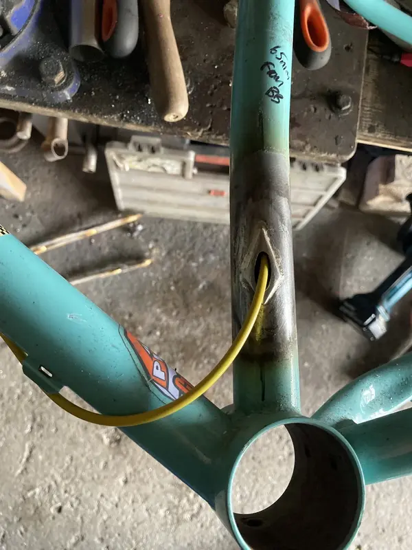

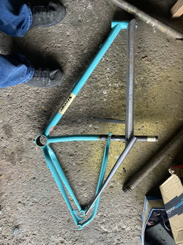

No build thread, only photo I have so far is from when I was looking at how to modify the frame.
It’s a mk2 Stooge that had cracked bring the toptube gusset on one side.
Andrew, the man behind Stooge, is actually sending me some bent biplanes so waiting till I get them and see how I can integrate them (it won’t be as forks, I already have a tri-plane fork I’ll use) before I fire up the torch.
I have figured out though that an externally butted Columbus seattube used upside down is a good fit inside the existing seattube so I will be doing that in order to extend the seattube a bit. I’m also tempted to add a bit of length to the front end.
The only brazing I’ve done to it so far is to add a port for dropper post routing. I have a 27.2 brand x post already so will be using that.
