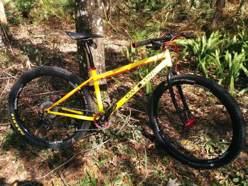

Haha I built the same frame into a rigid 69er. Went all OCD trying to get the geometry just right. It was a good conversation starter, and it had a nice ride but the handling was just comical, the front had WAY more stickum than the back so I was drifting all over creation. Riding it back-to-back with my Trek 29er, I don't think I gained anything with maneuverability and the rear wheel definitely felt more draggy. I was much quicker around the loop on the 29er and it was less tiring besides...

Found a picture.
It was a fun build. Gave it to my friend Bill cuz he didn't have a bike. He turned around and sold it a couple of weeks later to a bike shop for $50. Buh bye, Thomson seatpost and stem, buh bye to the last frickin Pacenti 26" rim on earth. Fork by Mark Slate, designed for his Blackbuck 29er... buh bye. Remind me to kick Bill in the nuts next time I see him
