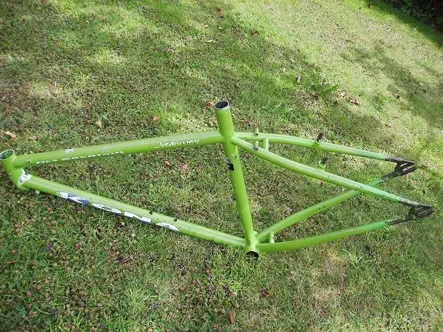

In the meantime, I'll try and get some pics of it. The reason I was so keen on this frame was it's had track ends added at some point, which is something I've always wanted to do to a Kona but it costs a fortune which I haven't got, and this frame was fairly cheap already done....needs a respray which is just as well....

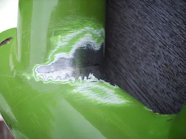

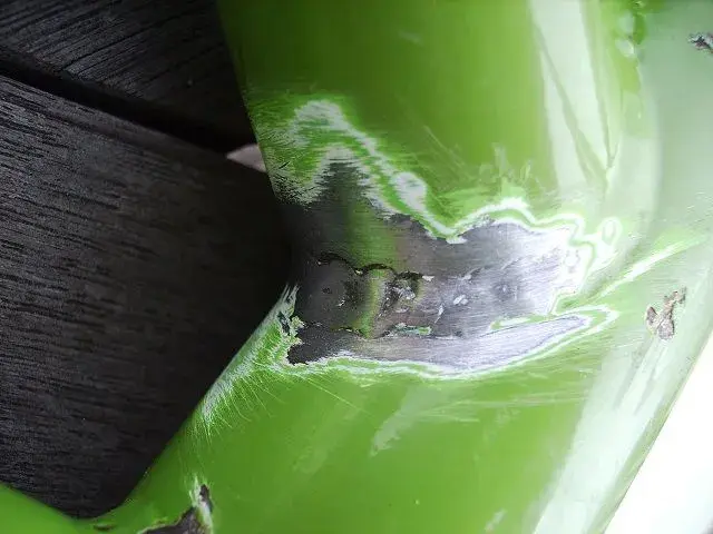

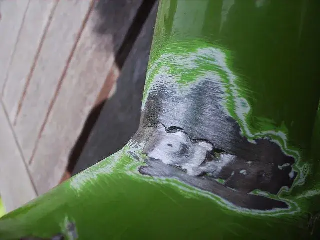

OK, here he is and here's the damage, what do others think....? :?

I was just about to reply to this, then I saw the pictures, that is defo not a good structural joint. If you want to have a go at torchwork yourself, try learning to braze, and run a nice wide brass fillet over this section. It should help a lot. It might not be the best-best given the short tube butts and heat affected zone, but as it it, it's the best chance an ameture will have at saving the frame if you want to DIY.
For future reference, if you get the paint off, run a "dye penetrant" test with an aerosol tester such as Magnaflux, that'll show the cracks pretty easily. Search on line, you should find loads of info on magnaflux. Bit less aggro than trying for an x-ray or ultrasonic test.

One to put down to experience I think. A further nail in it's coffin was the fact I've just measured it - having been sold it as a 16", turns out it's a 17", making the headtube 110mm rather than 90mm, so the P2's I had been saving for it won't fit anyway :facepalm:
Anybody want this as a wall hanger, or for the single speed drop outs? Mind you even they are a bit 'pushed in' on one side, i.e., you'd have to open the one out a little to get a wheel in.

Looks like undercut to me-where excessive heat or too slow a pass was applied by the welder and has dug in too deep.Its common enough.Its likely that there may be no structural issue.
Not sure I'd want to risk now thought to be honest, and still not convinced there isn't an issue around the seat stays too. You know what it's like when you've lost your confidence in something....! :facepalm:
That looks likes an undercut weld to me , repairable if you have a fabricator friend and the weld width is not too great.
