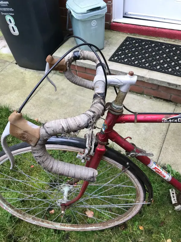

Hi all, I've just bought myself this bike for £10 for a little project over the winter, would anyone here know anything about this bike? Model year etc?
All I have so far is this image and the description from the listing "Gents 21 speed bike"
Thank you for any and all help in advance 🙏

Odd. From the colour of the frame and the style of the decals it looks like it's either a Tempo or a Panther. Tempo was 5 speed, Panther was 10. That's got a double chain ring but only set up for 5 gears (single lever, no front mech and no tunnel or stop for the other cable). Both models had drop bars which that bike used to have as those are drop levers fitted to flat bars. Saddle isn't original either.
from what can be seen in image appears to have commenced life as a Black Diamond, or lower, model (bottom of the range)
the frame's bulge-formed head is an Agrati item
frame ends & pump pegs look to be Cyclo
the welded fork crown is NERVEX pattern Nr. 4
this began as a rock bottom machine so does not merit a large investment of time or treasure
if you want to go through it and repack all the bearings & replace the consumables to get a well running and roadworthy cycle that would be fine should you envision retention and use
...or if you wish to do it as a learning project
in terms of funds it would take more to bring it up to full roadworthyness than it would be worth upon completion
so it would be wise to embark only if you intend to retain & use
Black Diamond had half-chrome forks, was only available in red or silver and had a model specific decal mounted towards the front of the top tube.

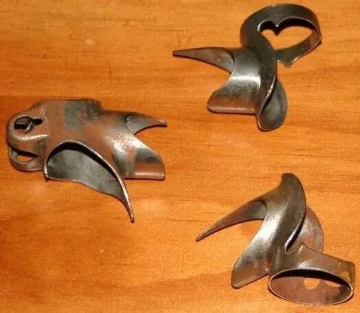

here is a no chrome Black Diamond constructed with Agrati "AM" pattern lugs and the same NERVEX crown as the subject machine
Ernest employed a fair amount of Agrati bits on frames during his tenure

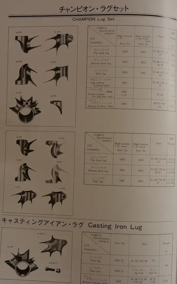

Tange is one producer who did replicas of European lug patterns
this Tange catalogue page illustrates the company's copy of the popular Prugnat 62/d
Tange Champion lug patterns, copy of Prugnat 62:d ,jpg.webp

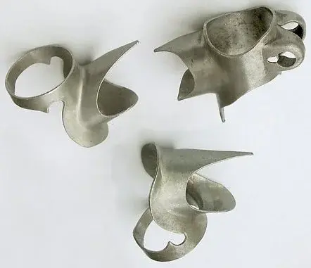

images of the Prugnat original -
Prugnat 62:d lug set .webp Prugnat 62:d set  .webp
the Agrati "AM" pattern N. 000.8040/E/U lug set shown on the red cycle above would have been gone by the mid-eighties as Agrati ceased the fabrication of pedal cycle fittings in 1982
The style of the downtube and seat tube decals on the red Black Diamond are mid-1970s, from before production moved to the Brigg factory. A 'Black Diamond' decal on the chainstay is one I don't recall seeing before.
BTW, I was wrong about Black Diamond being only available in red or silver, as originally they were purple with red as an option.
