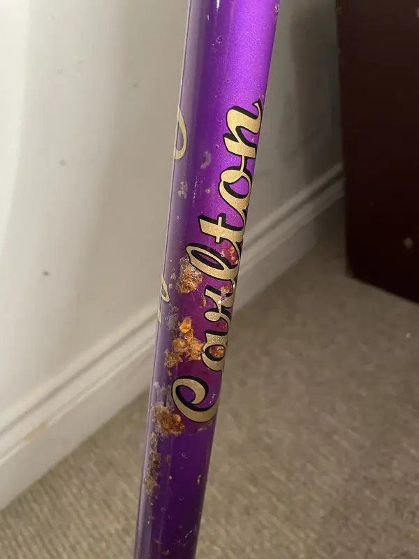

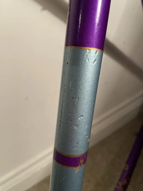

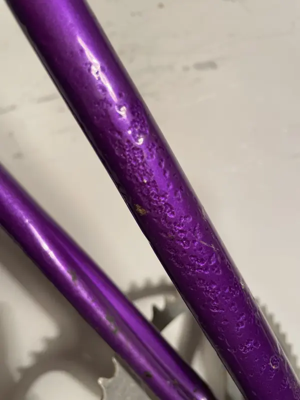

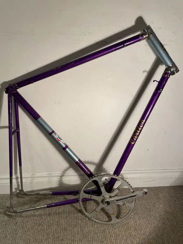

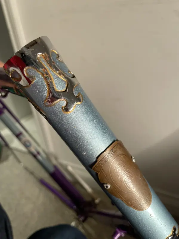

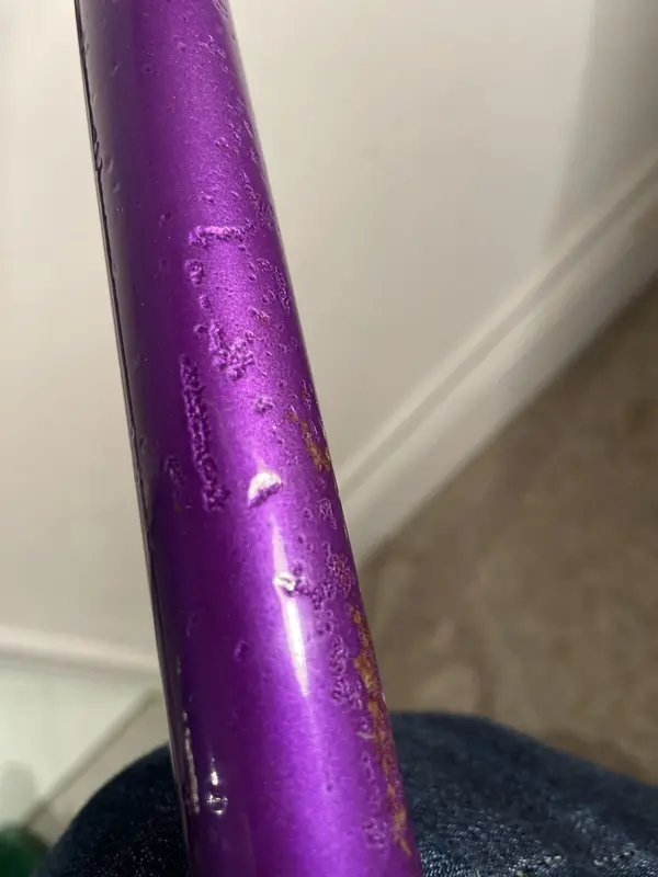

Help needed please I picked up a rather beautiful 1956-57 fancy lugged Carlton International recently however it has some very unusual wear to paint.
Have tried to capture it below not sure if the paint has a thick vanish that has been damaged or it’s just rust comings through or something else?
Any thoughts / recommendations on to repaint or keep as it, should I do anything to protect the frame, could it be to far gone to ride etc
Thanks!

Help needed please...
It looks as though it was chromed followed by some heavy pitting, followed by paint. Judging from the photos, the frame looks reasonably sound. In the event that you are willing, it would be worthwhile to strip the frame down and fill the pits. Sand blast would likely be the most effective means to dislodge any loose chrome. Next step would be an etching primer, then filler (JB Weld is a good filler for dents and large pits. Sandable primer/filler will work for the light pitting). It will be a labor of love, but you'll be proud of your efforts.
Thanks for the detailed reply, it does look like what you describe, paint over heavy pitting, I will do a bit of research based on the great info but will prob leave it to a professional to sandblast and filler! 👍✌️
