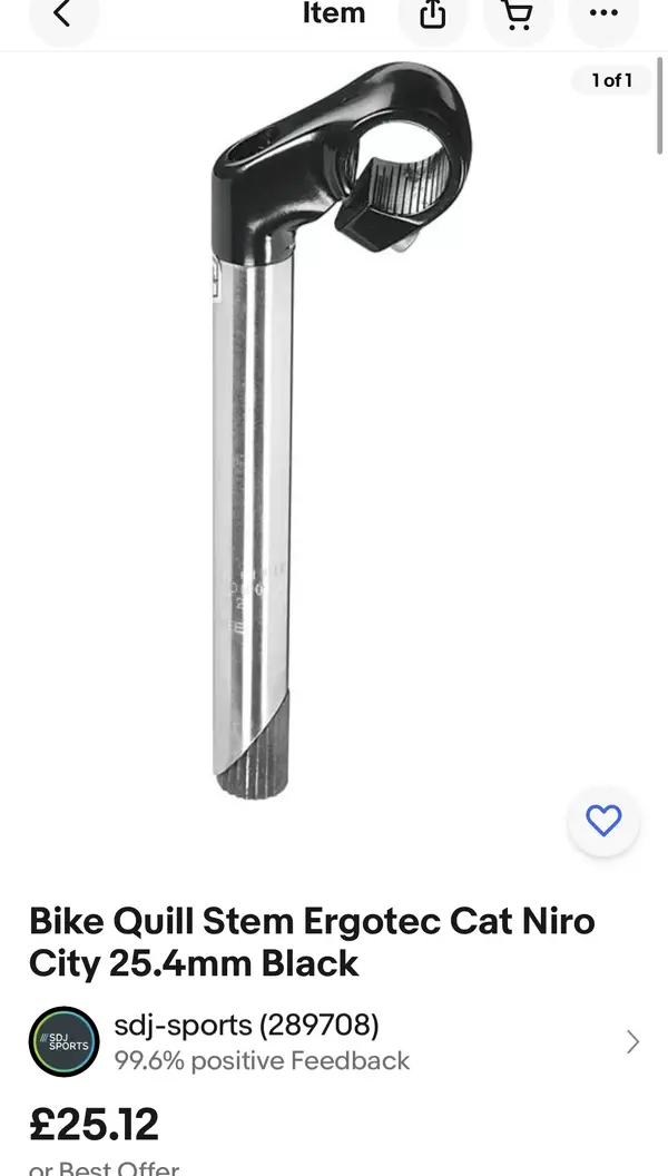

All he needs is bars level or slightly above saddle and less reach than that lancepole stem and I'm sure it'll be a pleasure to ride. I agree with people saying don't throw a lot of money at it, but a cheap taller zero reach stem like the one I shared will cost very little and achieve just that. I've yet to find a bike that couldn't be sorted with a bar/stem combination to fit me perfectly. I ride frames from 46cm to 60cm.
Thanks for all the replies - retrobike back pain experts, who would have thought it!
I think I’ll try a different stem first . Shame to lose the fluro original but im prioritising comfort over aesthetics… Maybe something like this…
