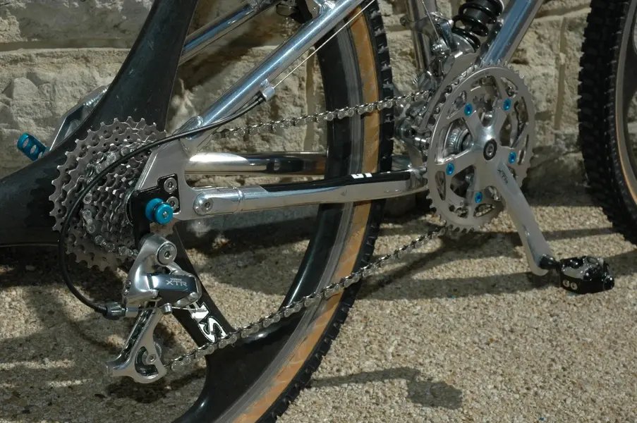

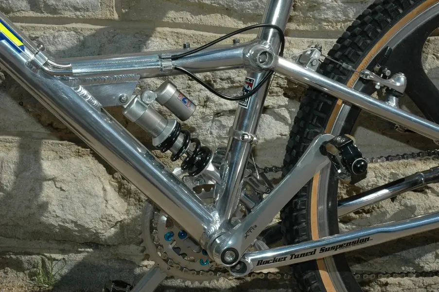

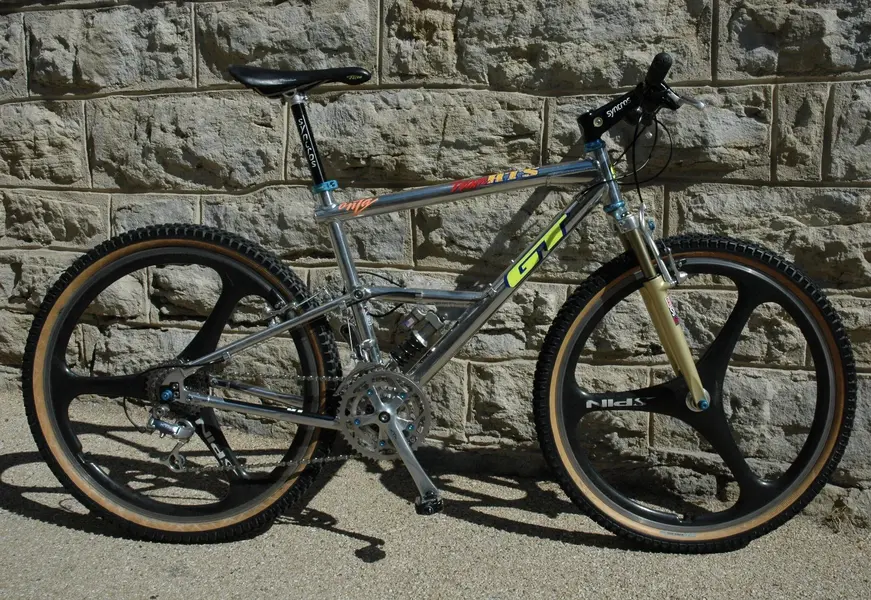

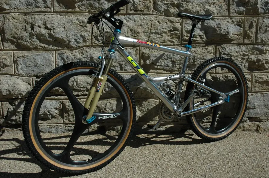

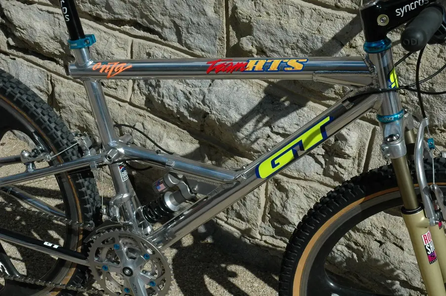

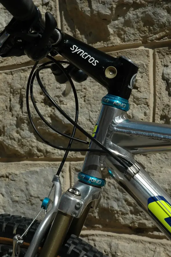

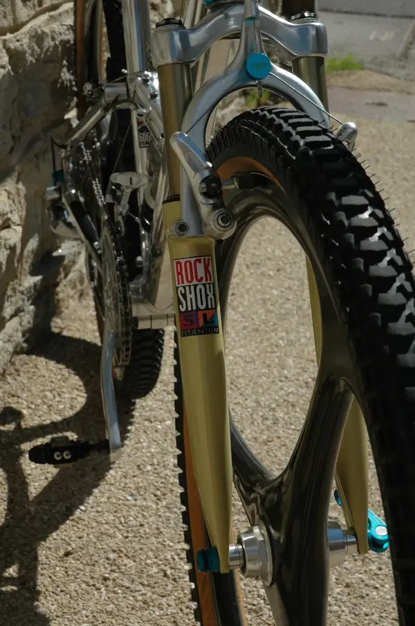

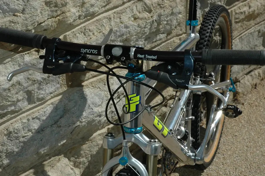

For the little story, for my first build from A to Z, I was looking at first for an early small Zaskar but without luck in my search I opted for this RTS from Marcin here. Happy with the result, hope you like it...
The build :
Frame: 94' GT RTS Team size 16"
Fork: 94' Rock Shox Mag 21 SL TI
Headset: Chris King No Threadset
Stem: Syncros Cattlehead 125mm / 15°
Handlebar: Syncros 570mm
Grips: ODI Mushrooms
Brakes: XTR BR-M900
Brake Pads: Kool Stop Eagle
Cantilever cable hangers: Onza chill pill
Brake Levers / Shifters: Shimano XTR ST-M900
Front Derailleur: Shimano XTR FD-M901
Rear Derailleur: Shimano XTR RD-M900
Cassette: Shimano XTR CS-M900 12/32
Chain: Shimano HG-71
Cranks: Shimano XTR FC-M900
Chainrings: Shimano 46/36/26
Chainring bolts: Bici
Bottom Bracket: Shimano BB-UN91 107x75
Pedals: Onza H.O
Hub Skewers: Ringlé Holey repro
Wheels : Spin's Tri spokes
Tires: Tioga Dawn Hawg 1.95
Tubes: generics
Saddle: Selle Italia Flite
Seatpost: Syncros dia. 27mm
Seatpost Binder: Ultimate Machine
Weight: less than me...
Thanks to the follow Retrobikers to help me to complete this build : @Magpiegifts , @dresdladiory , @prezza , @Corduroyboy , @ceo , @Double-E F , @wadsy , @albatros38 , @synlos , @Once A Hero , @romanrinos , @FMJ , @gil_m
