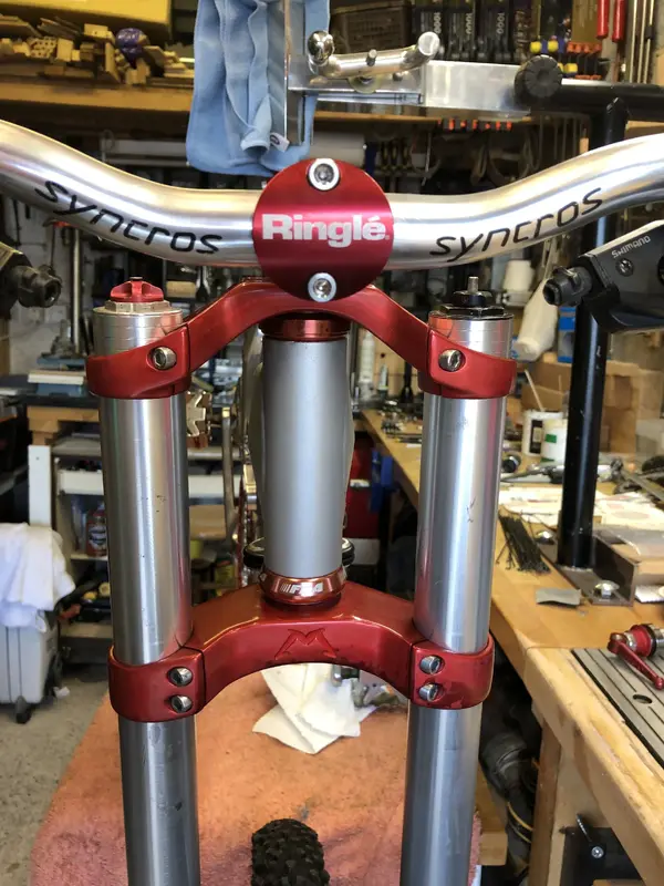

If it’s been partly out of the sealant when it’s sealing it can have a Matt finish that will disappear with WD40 but comes back.
You can see the marks on the lower crown.

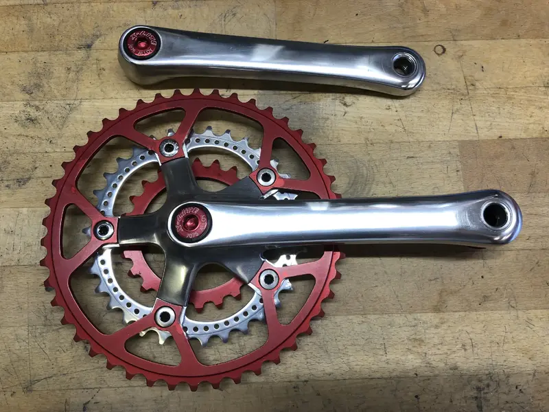

Middleburn rings are a pain to anodise. It is a funny alloy that has something in it that isn´t removed during the usual desmutting process. It is also very hard to polish to a good finish. The ones they anodised black seem to be to hide 'effects' in the metal.
The fork clamps have a problem with the sealing, either there is something wrong with the sealant (temperature, solution, foreign chemical). Or more likely it´s been taken out of the sealant (usually at 96-98 celcius) and left to dry when it should have been rinsed immediately. Or its been in and out of the sealant rather then fully immersed. If you run your fingernail over it is it a bit squeaky?
You can try polishing it with a soft car polish using a white soft cloth. Keep an eye on the cloth to see if the red dye is coming off on it, if it does then you are limited in what you can do. If it doesn´t, then you can try something harder like t-cut.

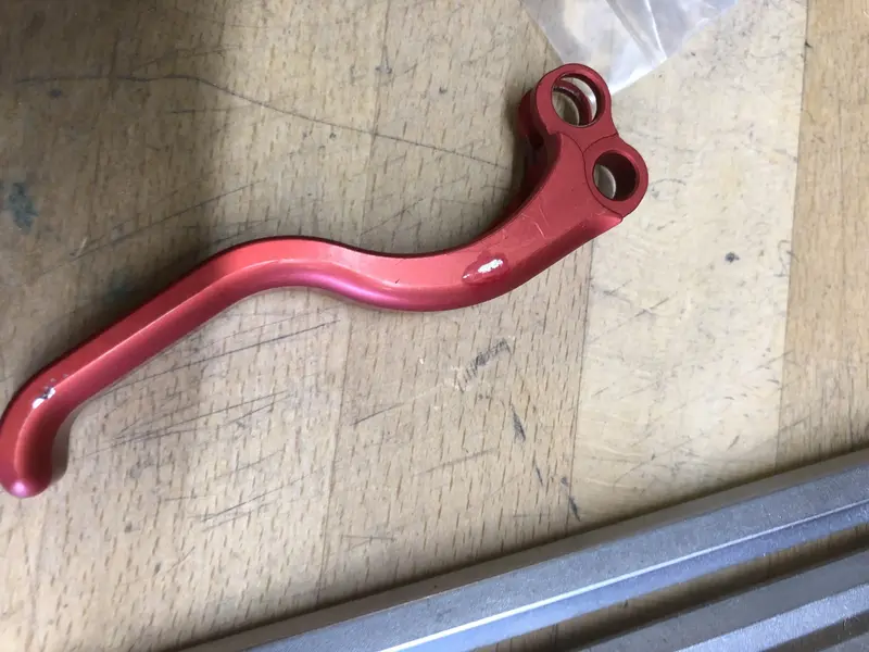

The silver patches on the brake lever looks like it hasn´t been stripped properly. The tiny bit on the bolt hole is fairly common, it could have had some thread lock on it or other compound stopping it stripping as fast as the other areas. I believe that the aluminium can get compressed on bolt holes, which stops the stripping process from working as quickly. On a bolt / bearing hole such as that, you don´t want to strip it too much as the size will change and it won´t be a good fit on the bolt / bearing anymore.
