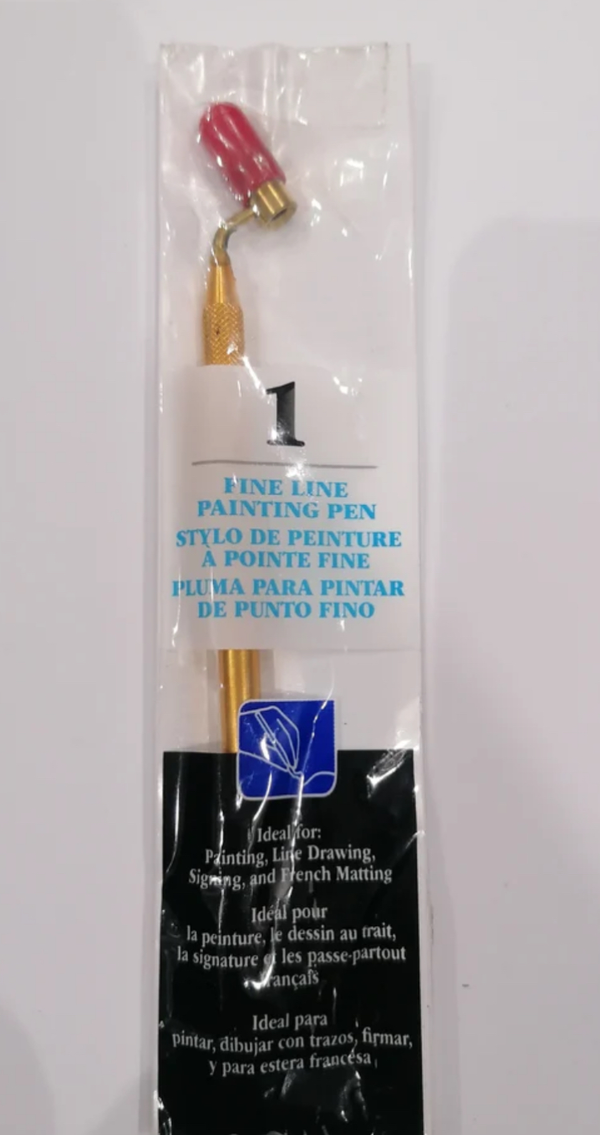

If you can get a paint match I’ve used a Loew Cornell paint pen for very small chips as well. You can put a tiny dot on at a time in the chip and build it up. You put a small amount of your chosen paint in the tiny thimble and it comes out a dot at a time from the nib, that’s covered by the red cap in the photo. The nib is small enough to fit inside the circumference of most chips. It’s not an invisible finish but can be really good.

I’d have to go through my wife’s nail varnish drawer again! I’m not sure any of my paint matches would much use tbh unless “almost Muddy Fox Courier white” and “looks only a shade darker than whatever Dave Yates used for metallic blue” are in demand. To be fair I did use a colour match for a Dyna-Tech Odyssey fork I found in a thread from @boy"O"boy
Cheers mate you know how hard it is to find a match so seemed a good idea to start thread i was hopeing for more intrest and the frame painters getting involved but it seems to be like pulling teeth with them like its a black art haha but that pen thing was a great idea as i was thinking airbrush tganks anyways
