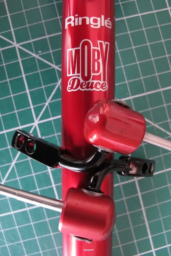

Believe it or not these have been redone but this time by Acorn.
Frustratingly, the chap there said they came out "bright red" at first but he then dunked them in his blue dye so that they'd match the Ringlé seat post I've given him to match...
They just look so flat :( but he did say the alloy was crap which is difficult to see given that Paul Components managed to do a good job!

They look like they’ve not been polished before anodising.
Red is a funny colour to do, getting it between light red that looks pink and burgundy.

Casper: I wouldn’t anodise them again, the diamemaions change when they are anodised (stripping reduces them more than anodising increases them). You can also get problems with pitting leaving black marks in the anodising.
You could try laquering them to get a brighter finish. Let me know how you get on if you try this please.

I may be being ultra critical but I think this will have to do :wink:

Looks good, I never got the chance to try it.
The black dots are where it’s pitted, either from too much stripping or it could have been damaged in its past and its corroded a bit.
