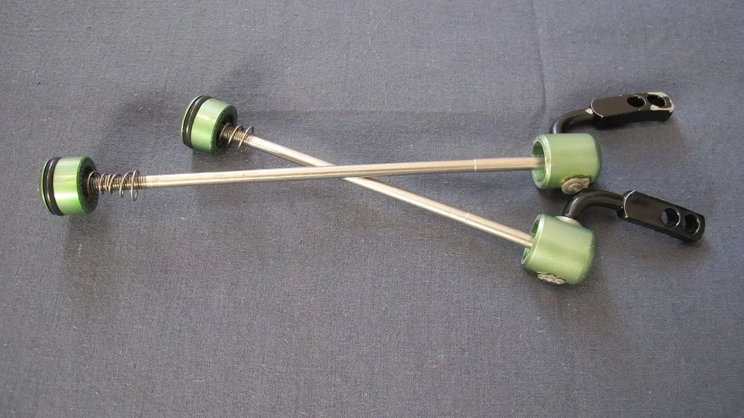

Took my Paul QR's to Reality Motorworks plus the trailing arm from my AMP B5 and picked them up yesterday.
The trailing arm needed polishing as there was quite a bit of chain slap which I'd sanded off and has come out great :D .
The QR's on the other hand are not right and it's bothering my OCD! They were dipped in Nitric acid to remove the old green anodising so the surface was etched in the process, so it's now very flat. Paul stuff is a bit flat/matt but not this much and the shade is very grubby. I think I'm going to have to get them redone but the guys at Reality don't think they could get any closer.

Nitric acid alone won’t remove anodising afaik.
They need either chemical brightening or polishing to get the right finish.
Agree. When I’ve had parts anodized I either polish them with my wheel or have the shop do it. You can achieve a very high luster with a quality compound and a polishing wheel on a drill or dremel if you don’t have a stand-alone unit.
What a disappointment.... The last stuff that Rampage did for me came back looking like piano black or very wet gloss
Those skewers look more like a base coat prior to having the clear coat applied..
I bought some faux (modern repro) Ringle skewers from a member on here a good while ago that were only slightly brighter than those red one, just couldn’t live with them - in the end they too were shipped to Chris and came back like NOS
This.
It needs to be an even polish though, it’s easy to overheat on aluminium and make it cloudy.
