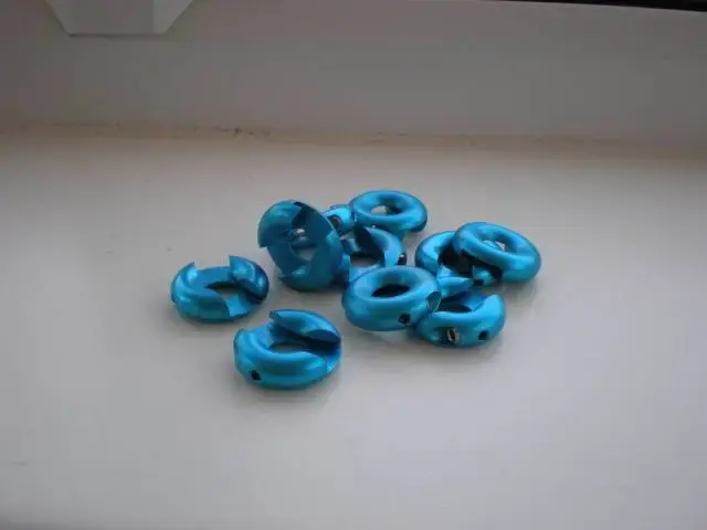

B3 has some donut shaped ones which look cool and are free floating like the above.
Yeah, get some of these....
:D

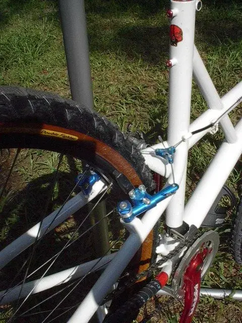

you wont get away with the stradle wire being fixed to one side its gotta float but you can easierly fit v's to an amp :wink: 8) 8)
Not true. You can use the Avid tri-dangle set to the side and locked in place, you just have to adjust the spring return on each brake to compensate. The offset cable stop on my white EWR requires the same set-up as the AMP. :D HArd to see in the picture, but the drive side cable length is about an inch shorter than the non-drive. Worked fine...at least until I sold the brakes on ebay and made some crazy money! :shock: :D
