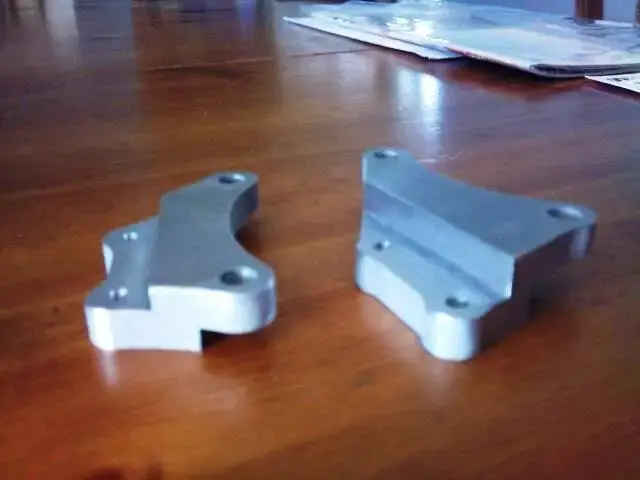

The blanks for these were cut this morning and are now in the machine shop waiting to have the step machined in them, this wont happen until next week, but I'm off on holiday Saturday :D so they will be ready for when i come back.
ATB
John
Hi Guys,
Back off my holidays now, here's the finished parts, just need to tap the threads this afternoon and they're ready.
ATB
John
