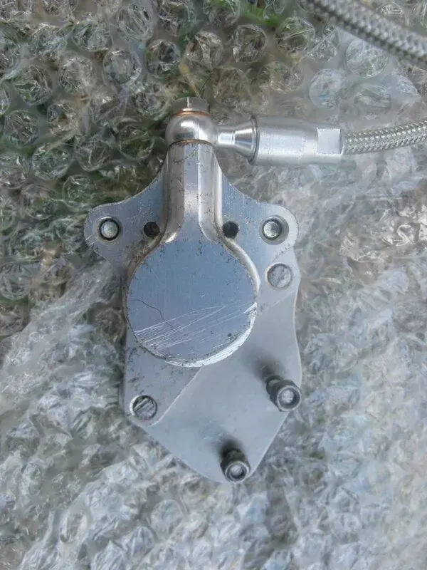

Sorry for the delay in posting pics of the mount I have, been a bit preoccupied with my small child of late. Anyhow, here is the rear mount that I have.
Ian

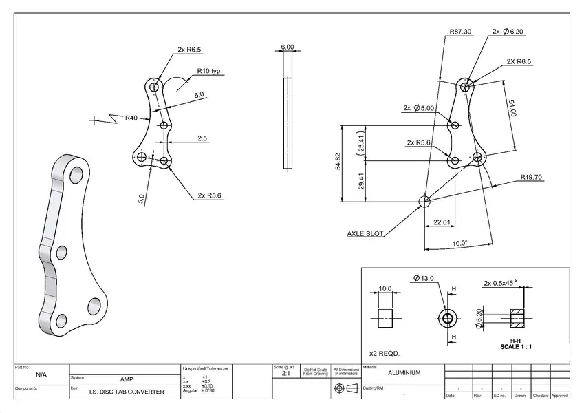

AMP disc adapter drawings
Here is my drawing of the adapter. The spacers (2x reqd) in the box in the bottom right are required to bring the disc caliper back into the correct plane for the rotor.
Use M5 bolts with the bolt heads on the INSIDE of the fork leg, going through the existing fork plate, then through the adapter, then screw on a nut (Ny-loc or Loctite please) onto the outside.
Alternatively you could tap the holes in the adapter and just not use nuts at all, but i'd not reccomend it. Why risk stripping a thread? Remember this is only aluminium. Just use a nut instead and make the holes clearance (plain) as in the drawing. make sure you anodise. Try googling Malden Plating, they will do it for next to nothing.
Hope this helps. Feel free to distribute. I can supply a DXF file for your local machine shop too, just email me [email protected].
This design isn't tested but should work just fine. Again, I take no responsibility though.
