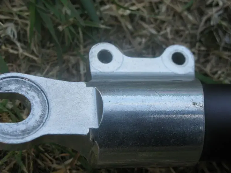

As requested, some pics of the forks that I am looking to mount disc on.
I measured the distance between the tab holes the other day, and if memory served me correctly, it was 25mm centre to centre.
Ian

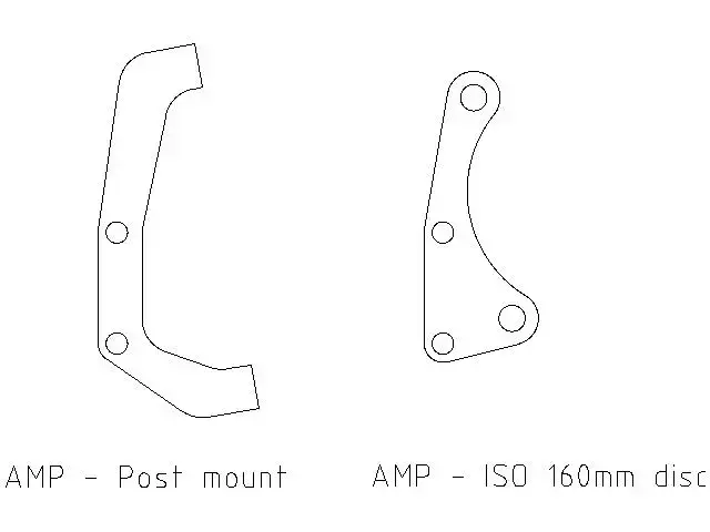

I've had a look at the front first, the post mount can be done in 10mm aluminum, the ISO will need to be in 4mm stainless, due to distances between mount and disc and being able to use ISO hubs.
Thoughts please......

The problem with the rear is that ISO is in the same plane as the drop out, any ISO bracket would need to be offset to bring the bracket into line. For the rear the easiest way would be post mount, as this fits in the plane that we need.

The two drawings I've shown above give you the option of using 160mm ISO mount discs and either post mount calipers or ISO mount calipers on the front. If +20 was required then this could also be done. Rear post mount will allow a 160mm disc on ISO hub to be used.
Easiest way would be water jet cutting, then secondary ops for threads.
