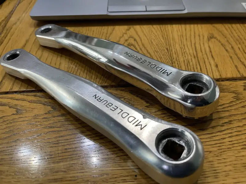

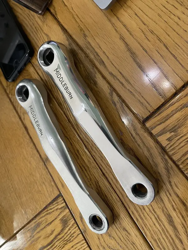

drive side crank arm almost polished fully - something to do while I wait for the chain ring to be delivered from France

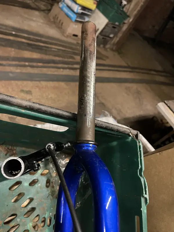

Forks steerer cut below the thread, shim welded in the middle and a threadless bar welded on top then smoothed. Threaded to threadless conversion done!

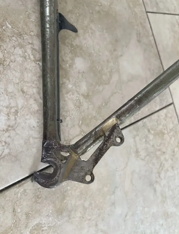

Disc mounts added to frame with support bar between the chain-stay and seat stay, fork mount added too.
I’m running avid BB7s for low maintenance reliable braking in all weather.

I like the threaded to thread less mod, very creative and difficult to keep that tube straight. Can’t wait to see it with the paint done. Looking good so far 👍

Haha, I honestly had a such an argument with myself about doing this. But on the first ride post disc mounts, I knew I’d made something special.
Yep the fork conversion was a must, I tried a different set of forks but didn’t like the look, then tried a stem converter. It felt okay in terms of the controls, but I found that 1. I didn’t trust it for the riding I was doing and 2. It moved around to much for my liking! That and I was keen to keep the bike original 😆 (last comment was tongue in cheek!)
