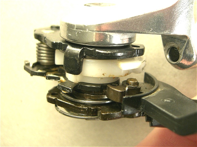

Now re-attach the mount as this makes it easier to hold and pull the levers. In this pic you can see the sprung pawl attached to the lower thumb lever. In granny ring position this rests/pushes against a big tooth on the black metal disc so not a lot can go wrong there:
In middle ring position the pawl rests on the edge of the metal disc underneath:
When you go for the big ring the pawl must quickly slip off the lower disc and engage against a tiny edge of the upper disc. Over time the pawl spring weakens and the surfaces are likely covered in dirt/grease meaning the pawl just slips right past. If you have the shifters at a steep angle like me the spring also has to work against gravity making it less likely to engage:

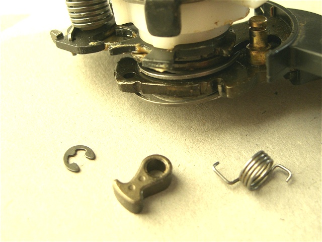

Luckily the circlip holding the pawl and spring is fairly easy to remove:

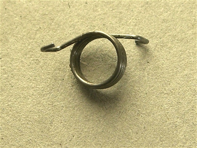

To add a little more tension to the spring I pulled the end hooks towards each other. You only need to bend the spring a fraction though, too much tension and the pawl will get stuck in the position in pic 4. This is the shape of my spring when I'd finished:
Getting the pawl and spring back on is a bit of a fiddle but not too bad. Grease the pawl pivot to help it rotate smoothly but keep any grease off the face of the pawl and can only make it slip.

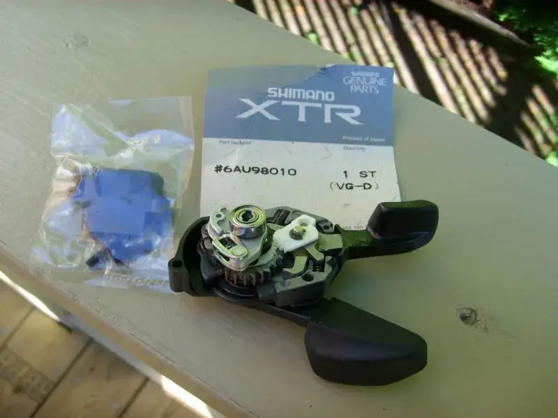

Just a question about the similarities between these, and XTR M950 sti's/shifters.... as you seem to be The Man for shifter knowledge
Only ask as my right shifter has an intermittent but probably getting worse in hindsight issue. When you push the thumb to go acreoss the cassette (to the left, shifting down) it will slip through where the initial engagement would be, and only pick up the shift right at the front of its rotation/movement
Dont want to take them apart without any pointers or words of experience
Cheers
G
Haha, I'm not really "The Man" when it comes to Rapidfires... The set above are the only ones I've ever owned!
I've found a picture of an replacement STI shifter which suggests the XTR shifter will come off quite easy and give good access to the mechanism. Looks different but I can see it works on the same principle. The light grey part hiding on the lower left should be the pawl and it does sound like the same issue I had.
