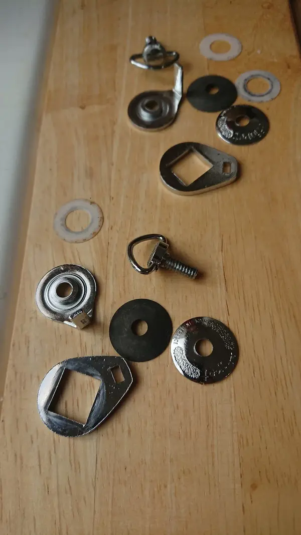

I am a fool:

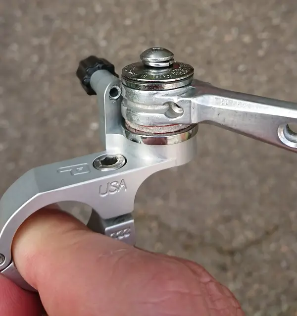

I didn't realise this part would come off the bracket.
This now gives me:
So a nylon washer beneath the lever and the cable should be close enough to run smoothly, right?

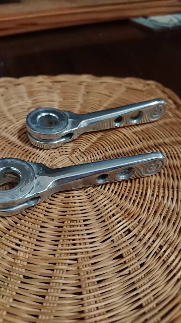

The levers had some light surface corrosion. I didn't want to get them really shiny, as most the components I'm using have a more satin finish, so I just removed the worst of the corrosion with wet and dry and then gave them a little polish:
Probably a little shinier than I intended, but I am sure that will fade a little in time.
Mocked-up with a fabric washer. Then photo taken at an angle where you can't see the alignment, but it looks just right. I now just need to find a couple of nylon washers the same size.

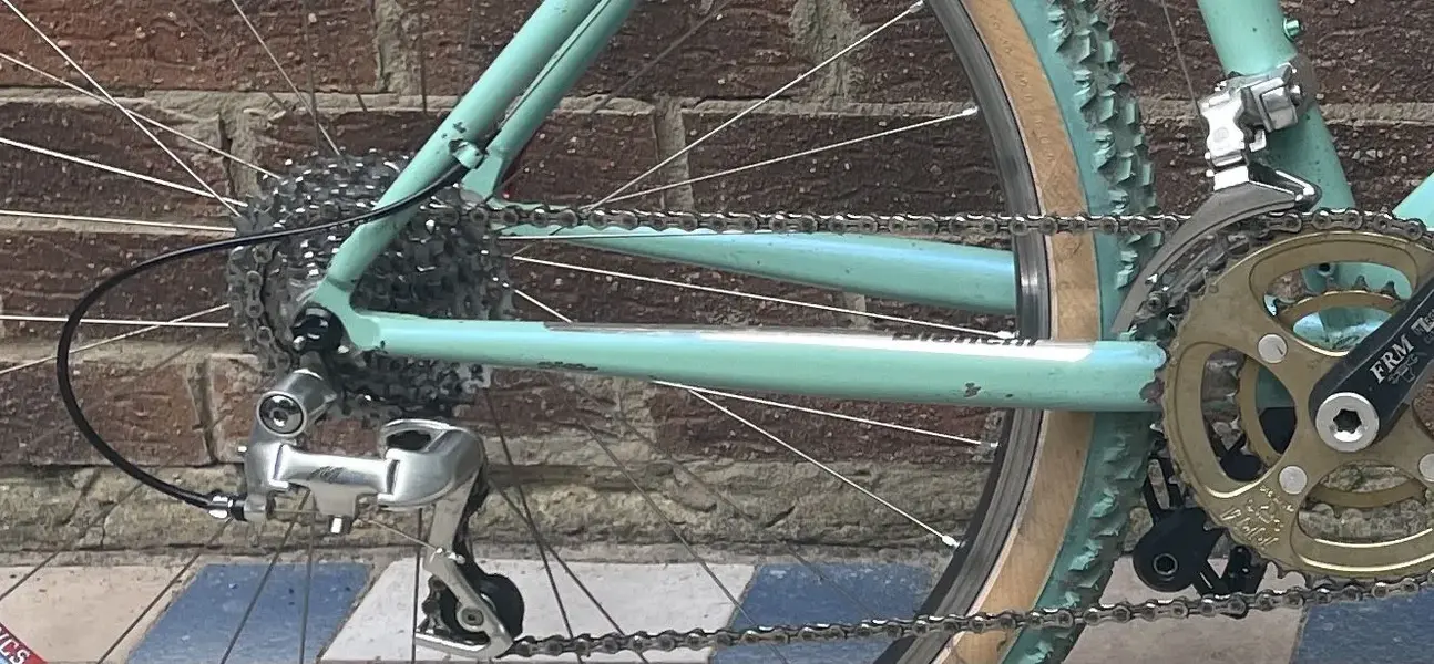

Good idea. I did much the same here

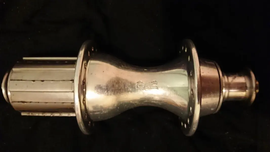

A possible alternative solution for the wheels ...
Matching front required, but it would fit with the European build, as well as silver bodies probably fitting in better than the black carbon of the Nukeproofs.
That’s a very interesting idea - I’ve seen a few on sale here and there but very expensive ! Absolutely beautiful
