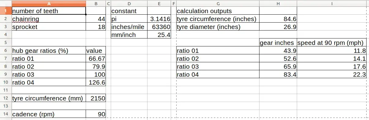

It’s got a 4 speed wide ratio Sturmey hub with 18t x 44t and on this run I pretty much only used 4th & found myself often freewheeling (the Fiamme rims do roll so well)
Can anyone advise what might be the better option, 18x46 or 16x44? (combined with a 4 speed close ratio Sturmey hub gear)

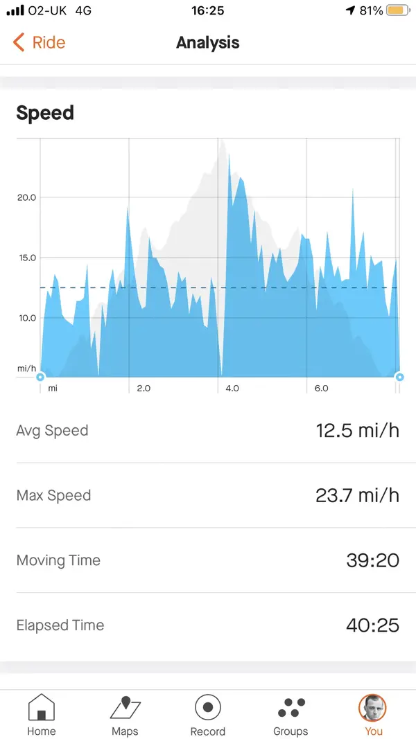

I think 22.3mph is quite respectable! Or maybe Peachy just isn't pedalling at 90rpm!
Not sure what my regular cadence is but I’m pretty sure I can pedal faster than 90rpm especially down hill.
Here’s a screen grab from Strava, I maxed out downhill at just over 23mph, whereas on my geared Claud I’m normally reaching 35+ on that section and averaging 15.
I think the average would have been more than 12.5mph but I had to pull over for tractors and didn’t pause my phone. 426A65BB-BFF2-48AB-AE26-DD7DF1C1BD7F.webp
