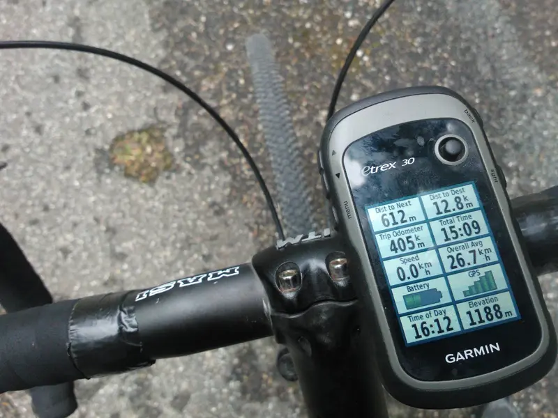

Finally....yeah....for riding it's metric:
