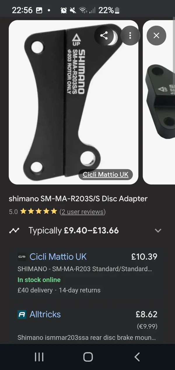

D dan28 Senior Retro Guru Jul 4, 2025 #5 You need a 203mm IS (.International standard ). Fork.mount Doesn't have to by made by A2Z
D dan28 Senior Retro Guru Jul 4, 2025 #6 Just had a quick look on e Bay couldn't find anything. Google it an found this Attachments Screenshot_20250704_225655_Chrome.webp 67.8 KB · Views: 2
