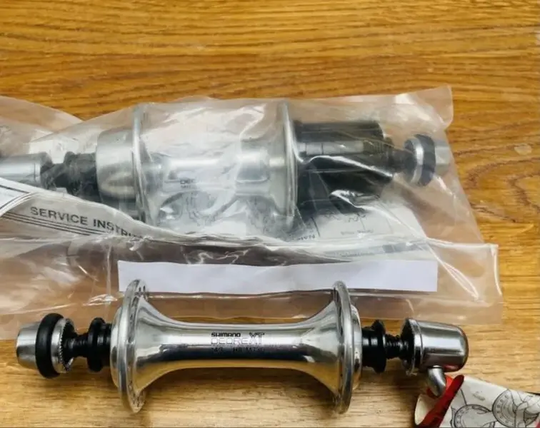

I’m selling some Nos XT hubs, rear is 130 7 speed
They do exist? - I'd be all over these Mark....but with correct rims now purchased and en route....I now need 36H hubs.
https://www.ebay.co.uk/itm/26664042...Hgwr3rfR1i&var=&widget_ver=artemis&media=COPY
I've seen these on eBay. Bought from seller before and seems knowledgeable on the subject....but thought this might be a typo error. But having seen Mark's post....they could be legit 130mm 7spd?

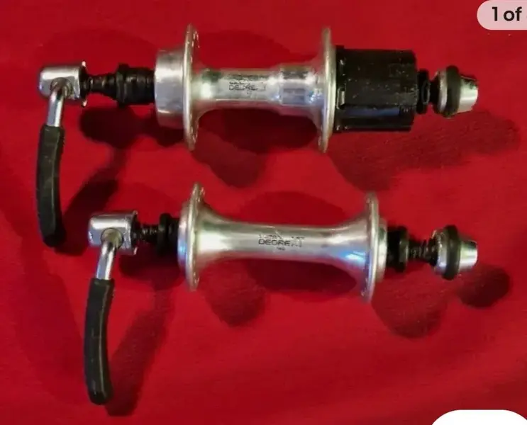

So I've looked at probably 10,000 fhbs in the decades of a busy shop and at a glance, the length of the fhb on these German ebay numbers make them a 6 20240229_082135.jpg
And then the ones in a bag are 7: Screenshot_20240229-081846_Firefox.jpg
If I pulled them out of the drawer (blindfolded obvs) I would say the top one is 130/6 and the bottom 135/7
... but we've been looking for the unicorn of 130/7, and see a vision in the clear morning light that is hard to deny!

The hub bodies are different shapes between m730 and m732. The shoulders are square on m730 and rounded off on m732. Also the grease port is different.
The top pic is m730...bagged m732.

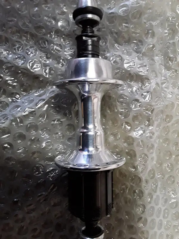

These below are all 7sp 130mm m732 hubs......i would give the spare to @boy"O"boy but its earmarked for some wheels sadly. So thats 4 of them, and those are just the ones laying round my house! Unicorn.....donkey......as most want 135mm to fit their frames.
