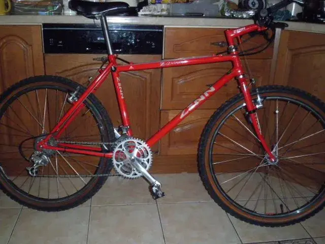

made some adjustments to the Zinn, trued up the front wheel, changed pedals checked all the bits were tight :wink:
A quick 5 mile loop to see how it rides...Very nice!
Feels very lively/alive with the steep road angles and stretched position.
Tomorrow im stripping the hubs and checking out what lurks inside..
Progress
Over the weekend i made a start on cleaning up and checking over the Zinn.
Serial number is Z92231 that will make it a 92?
Stripped both the hubs down! The rear hub required a new cone on one side and fresh bearings. I used Phil Wood grease to pack them. Quite an education putting the 8 spd cassette back together. Each cog has a set of letters, and they have to be put back on in a specific sequence depending on cog size :shock: Anyway it wasnt to bad :lol:
Next thing was to polish up the frame and look for any problems. Not bad at all for a 19 year old bike.
Next few days ill strip the headset and bottom bracket and tidy up anything else cables etc.

Yup, a 92. Looks nice and clean, its thick powdercoat eh?
Read somewhere that the paint is stove enamel. :idea: It really came up well with just a wee bit of elbow grease :roll:
I will definately take some proper pictures to try and capture the condition of the bike.
