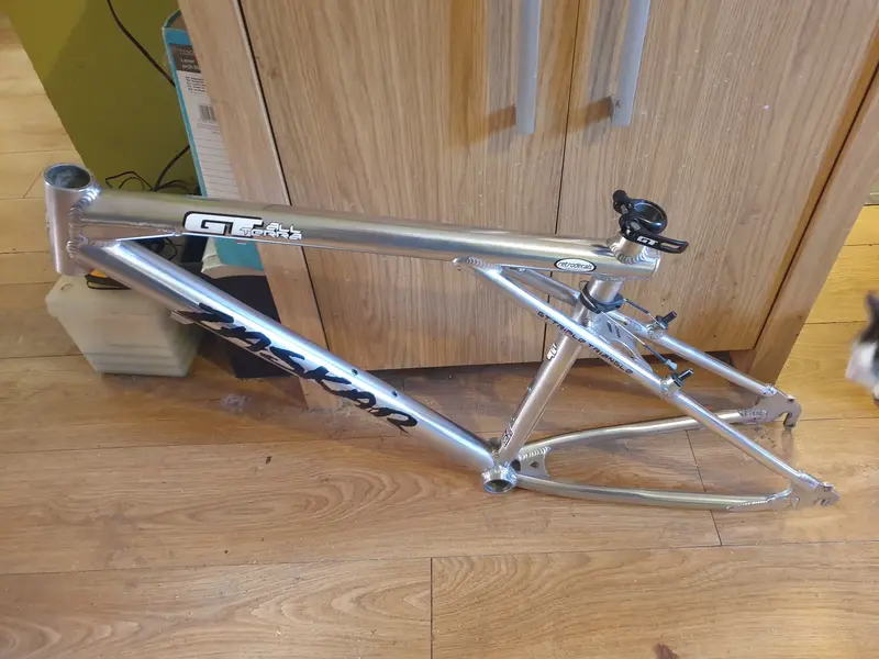

A quick preview of what's to come....1991 GT Zaskar project.
