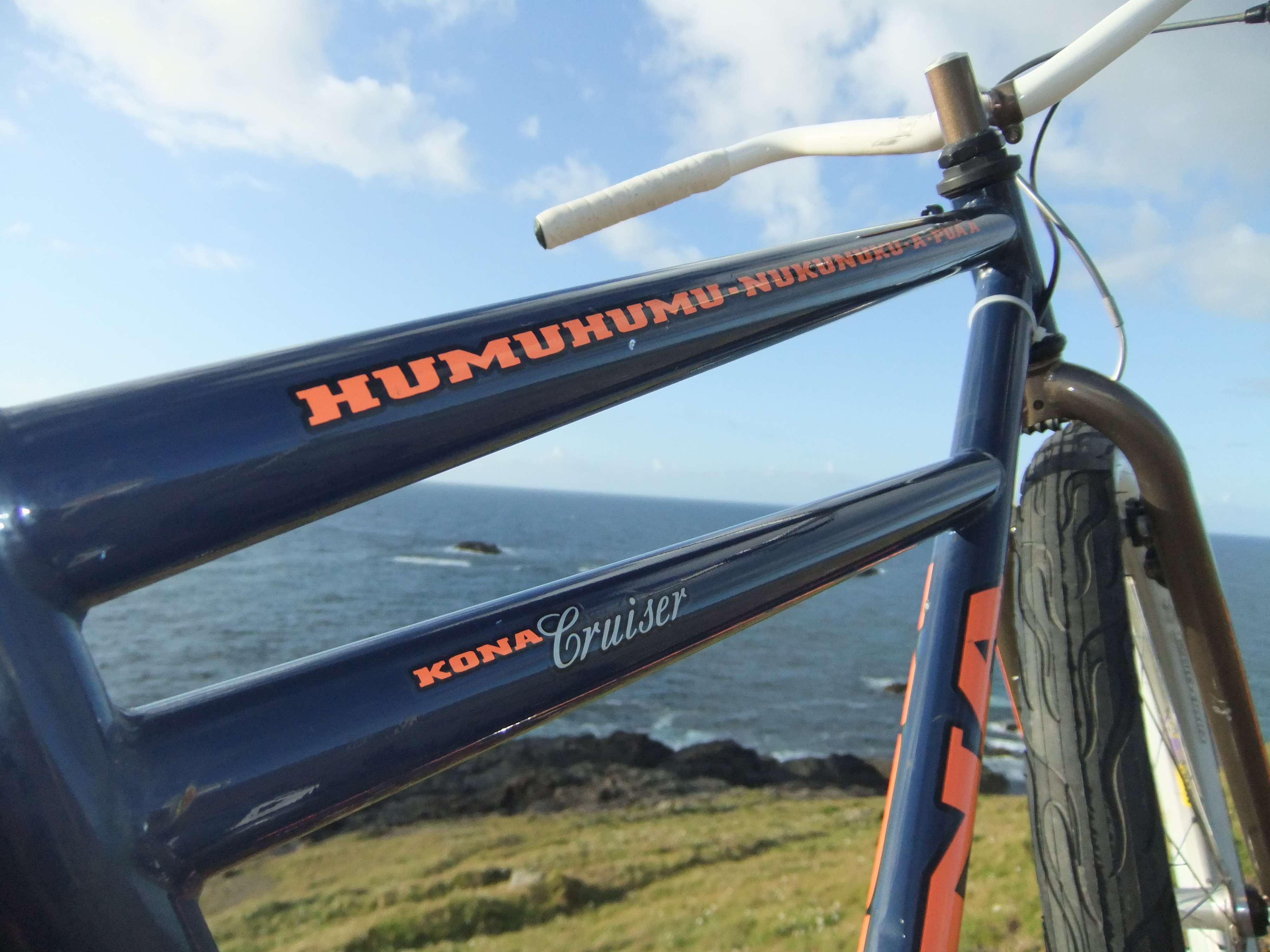

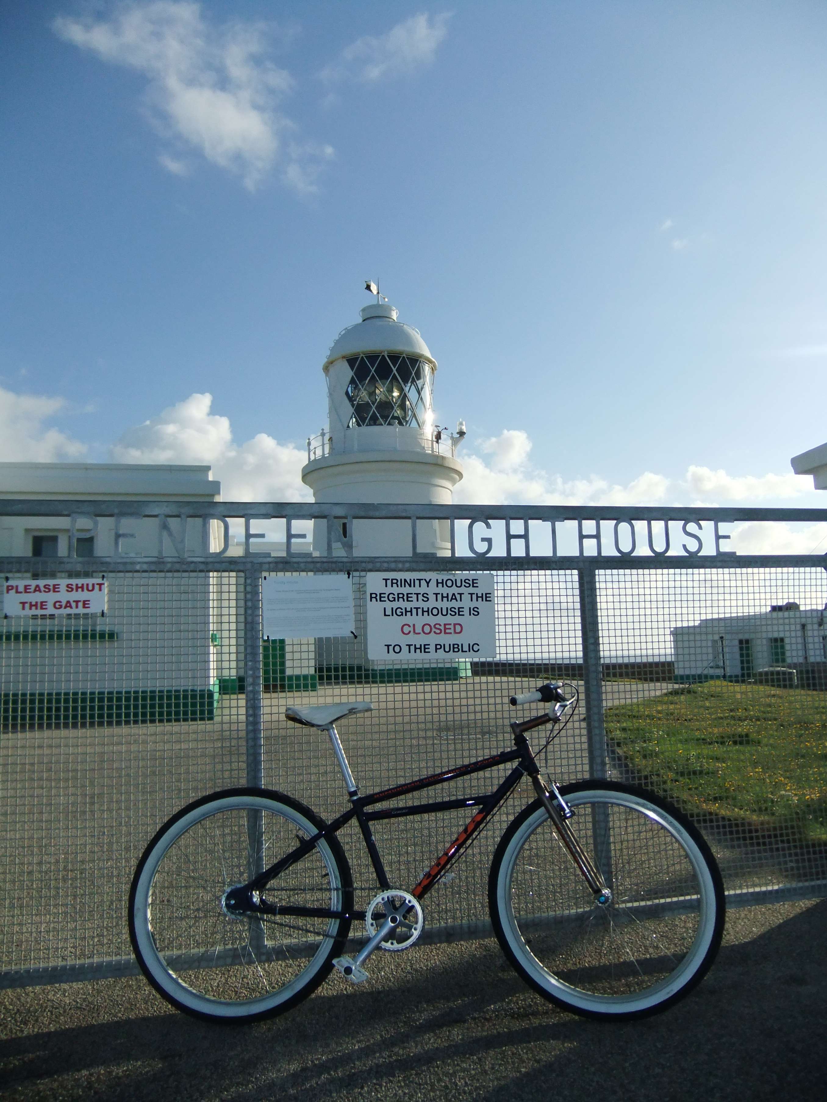

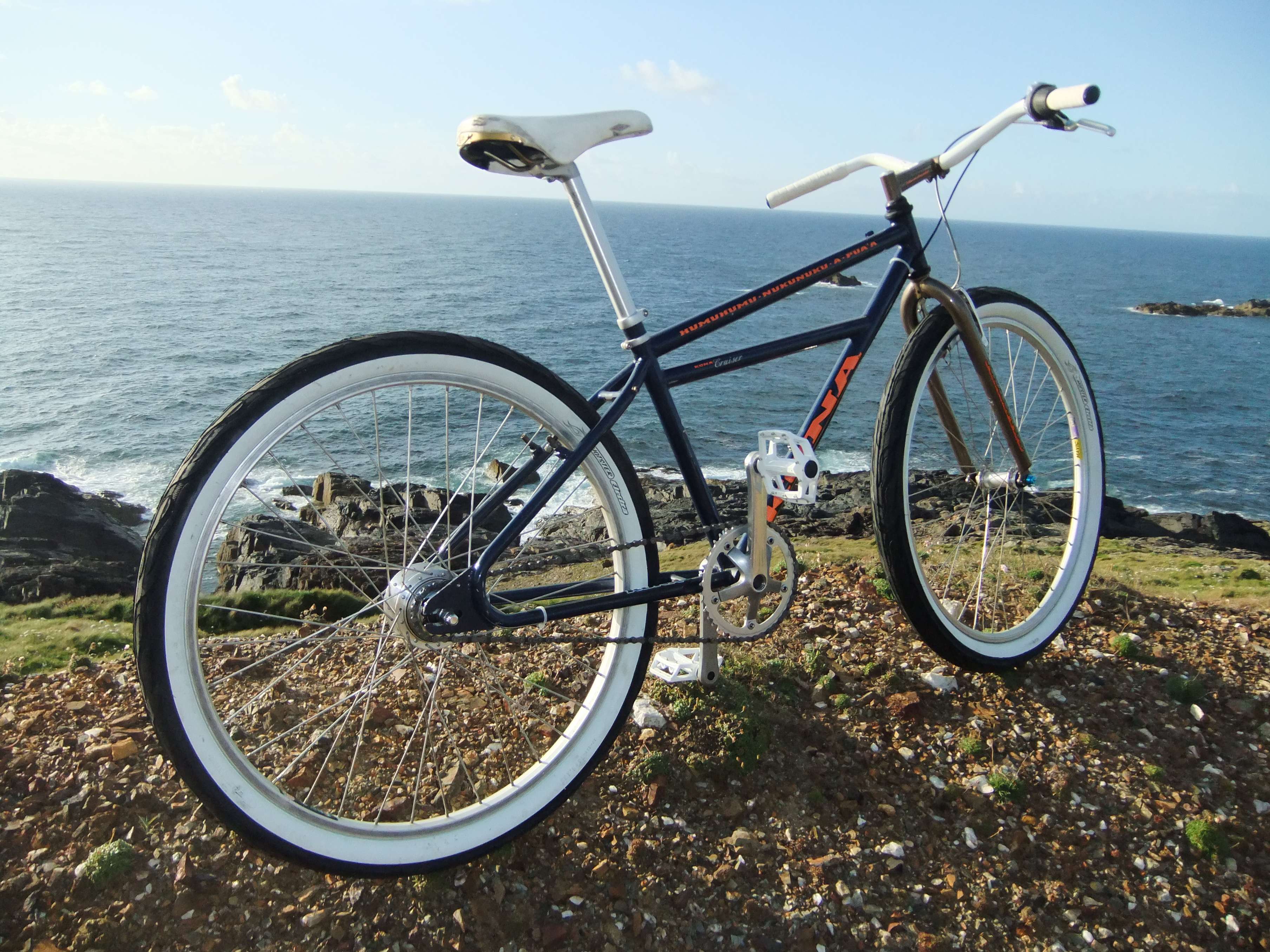

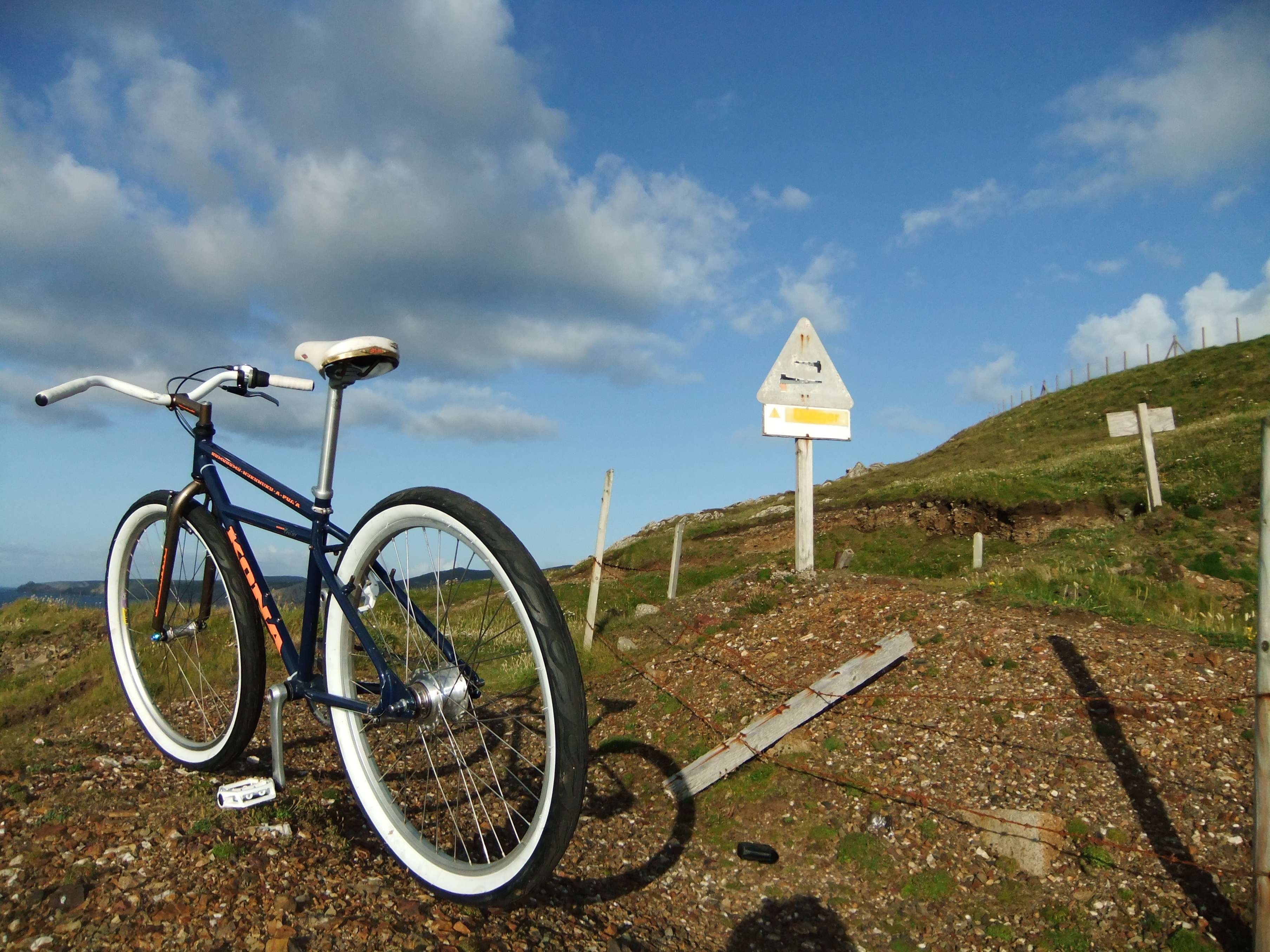

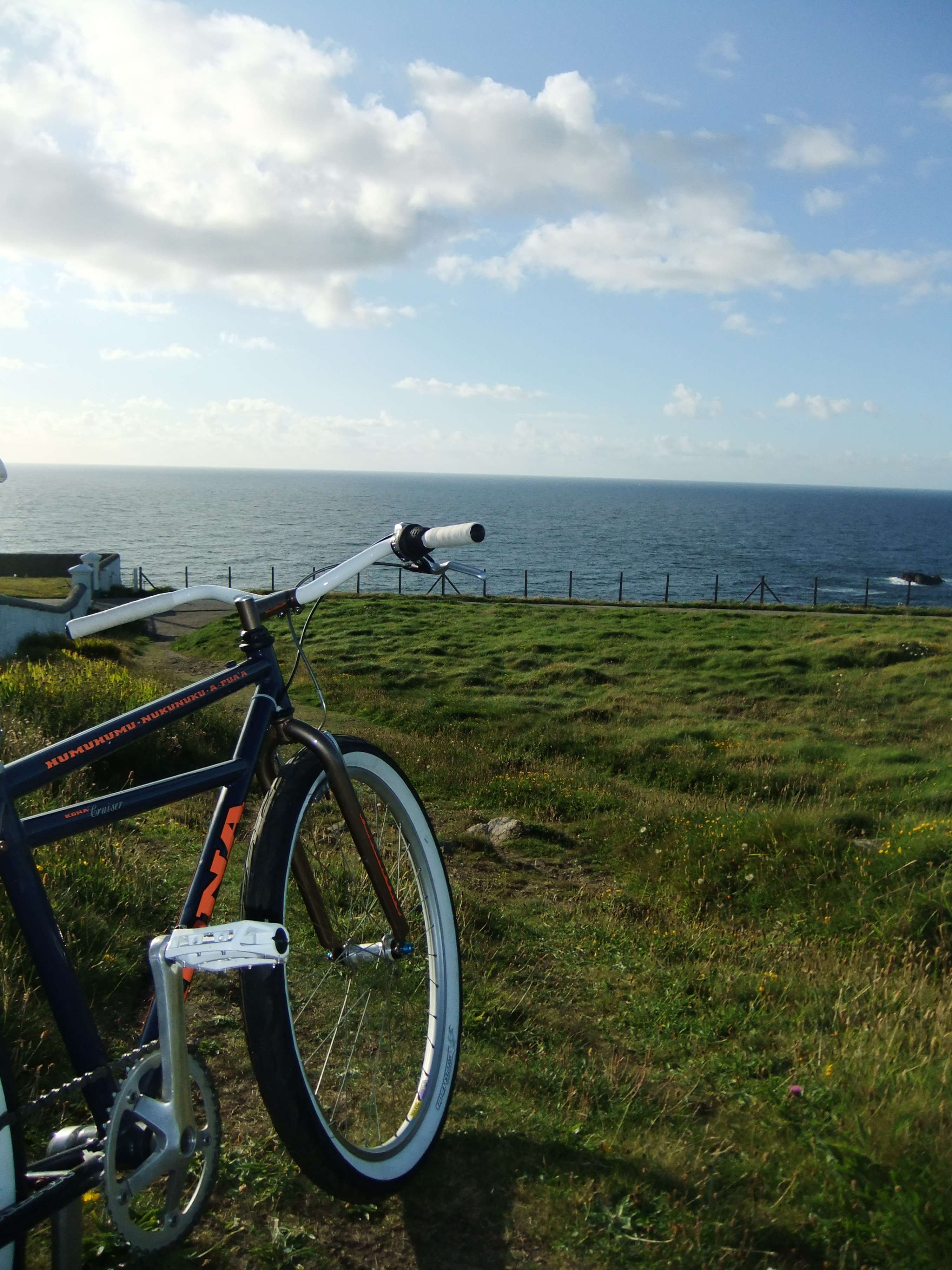

Had a quick ride out this evening and got a couple of nice pics. Shame I made a schoolboy error and forgot to tighten the cranks bolts and had to walk halfway back :oops:
Yep, paint and decals are original. A little bit tatty but would never repaint it, I love the colour scheme :cool:
