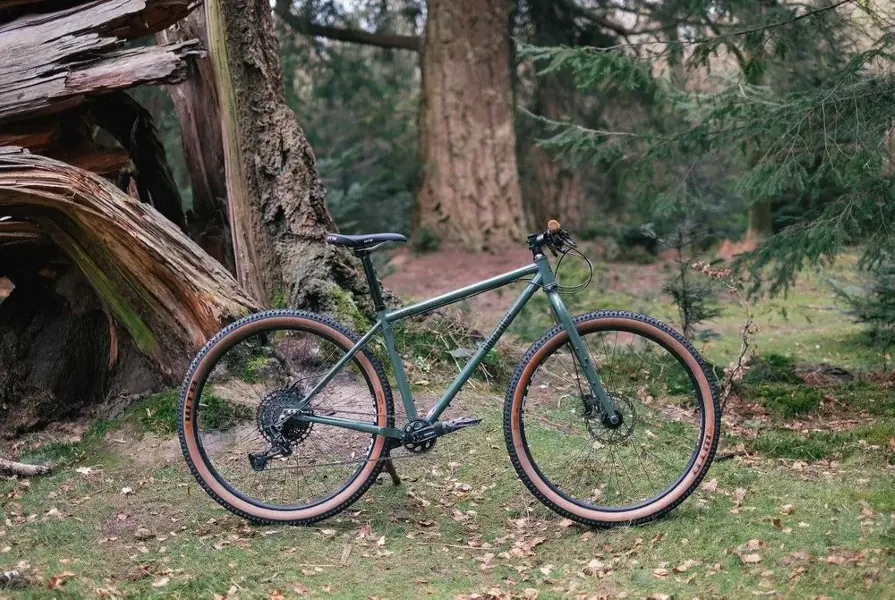

Just after a bit of advise and maybe some suggestions. In early Jan I placed an order for a Brother Cycles Big Bro Frameset with an estimated delivery of early Feb. It's now likely to be beginning of April. I understand the current issues with lead times so I'm disappointed but it's not the end of the world.
The dilemma I have is they've also changed the rear wheel spacing from 142x12 to 148x12 boost. The wheelset I have uses Hope Pro ii hubs (not EVO) and Hope tell me they can't be converted.
So I have a couple of options,
1. Get a new rear hub and the wheel rebuilt, sell the old Hope hub.
2. Get a new wheelset and sell the Hope wheels (my budget is what I'd sell the hope wheels for plus maybe £50).
3. Get one of those dodgy boost converters from eBay, no knowledge of experience of these.
4. Cancel the order and try to find a similar 29er Steel frameset with 142x12 or even 135.
I'm a bit miffed as I was really pushing my budget and didn't want to spend any more cash. Anyway any thoughts on what should I do?
Here's a couple pics of the Big Bro :cool: .
