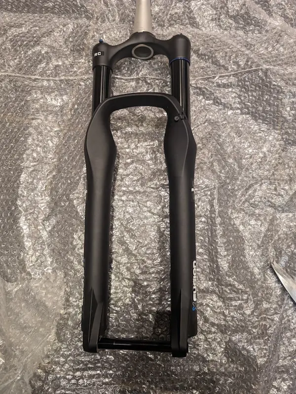

I hope to sort a couple of bikes over the Easter break. One is a bit of a rebuild for my eldest. I've been silly and bought two forks for this. Impulse purchase recently was a set of 22 x-fusion slide RC which I've yet to receive but look as new. Travel is 140mm so about right
A while back I bought some pikes. Charger damper, I think around 2020 vintage. I truth I bought 2 sets, the first had light stanchion wear, but planned to drop travel down to 130mm. The other very tidy but need to drop travel (I have the required parts for this).
Both forks are boost, I'm going to run an adapter to allow non boost wheel on them unless I can find a matching boost front for the rear.

Thanks for the reply. I think one set of pikes have the RC, the other rct3. I've no experience with either damper, not had one with a bladder before, well not ridden one, have some dvo diamonds on a build that's taking ages to finish. What's the difference between the 2 dampers that makes the rct3 better? I may need to swap things around if the best damper isn't in the better condition fork.
The x-fusion arrived today. Absolutely mint, look almost new. I'd like to know more about them, all the marketing spiel is similar to every other description so real world experience is needed to help me choose.
That said, the simplest option is to fit the x-fusions as they should be the right travel without changing the internals which I need to do with the likes. I'd still prefer to fit the better fork, as even though my son won't know, I will.
RC is rebound/low speed compression adjustment. RCT3 had a three position compression dial (Open/pedal/firm) as well as adjustable low speed and compression.
Not sure of the technical details inside the damper but it just felt better, especially the further you went into the travel.
