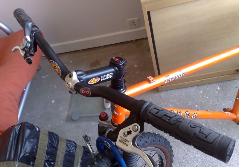

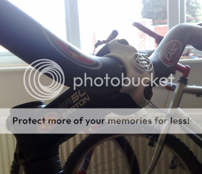

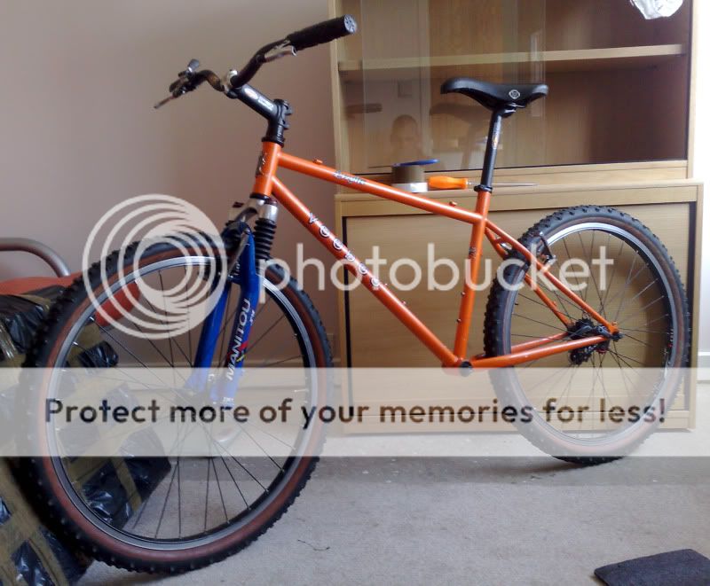

Getting there...
Full of Easton Promise

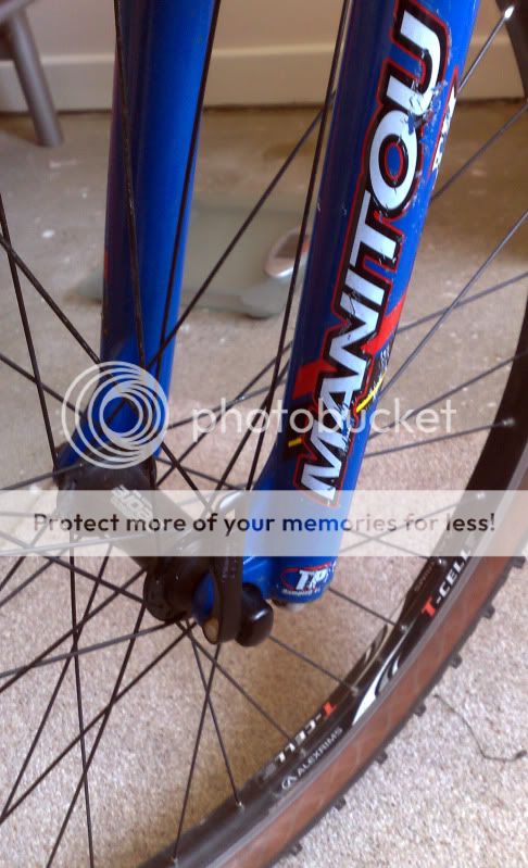

Deore hubs, Alexrims TCells and the Manitou's (that I want to change for some Z2 BAM's (see wanted ad ;) ))
It's all bolted up loose, Wife will decide everythings final resting place..
Waiting for cables, XT rear mech and Chainset (choice of black Bontrager or polished XT.. not sure which yet - will decide when they arrive)..

Not finished I don't think but getting there..

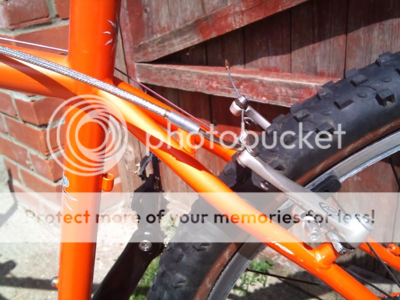

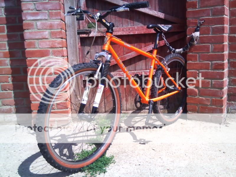

Added Avid 2's, 36T ring, Rhythm Pro seat, braided look cables and RaceFace Deus headset
The cables are going to be changed this week (need to get some of that tube to go over the exposed bits then I'll crack on), she could do with a different seat too I think (although that Rhythm Pro isn't too bad for her) and I may whip a link or 2 from that chain..
Hopefully Gil will sort the stickers for me in a few months too.. just need toptube and downtube to tidy it up.
Pics aren't great . . .
8)

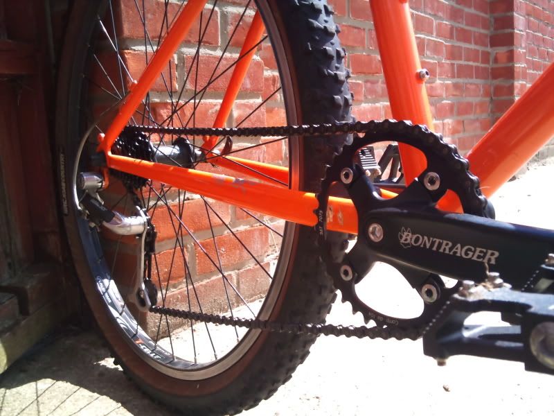

Looking good. So on your 1 x 8 set up do you not need any sort of chain guide around the bottom bracket?
Not so far, but she's not ridden it much . . the front ring is unramped etc, not sure if that helps..
Need to fiddle with the shifting a little, can't get it on the big ring at the back . . will do that when the new cables go on ;)
I rather like the way it's looking.. once the kids are back at school we'll be out a lot more ..
