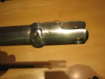

I've had some new rear stay-ends made up on a lathe by a friend of my Dads who's into building rather nice Manx Norton race bikes.
They have been welded on after the old ones were removed (the new ones have extension plugs which go inside the seatstays).

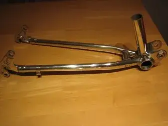

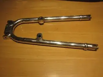

I'm in the middle of stripping off the old laquer & decals off the front end prior to its respray, and i've already polished the rear to a mirror finish :)

Hers's the pics of progress so far.
