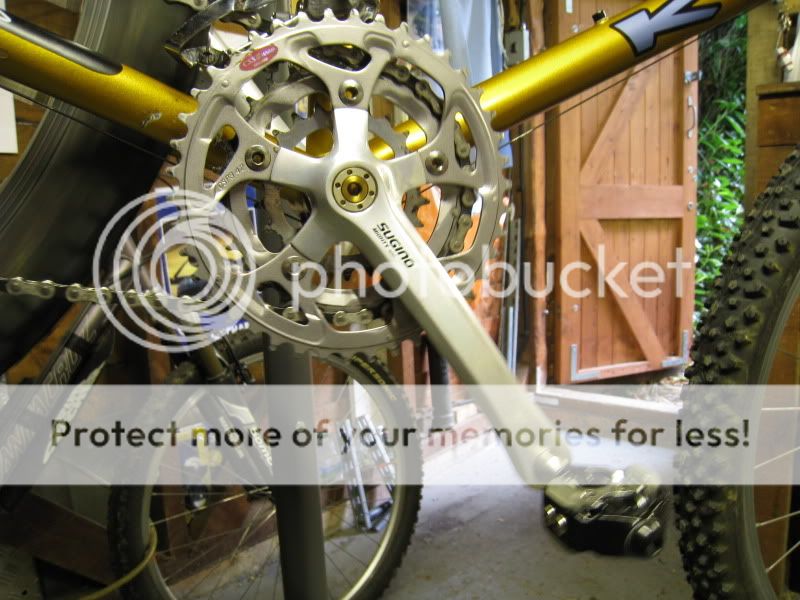

I discounted the XTR as that uses it's own bottom bracket, not sure what the RaceFace uses.
Current Middleburns (RS7/8) use 113 length, but look to me a lower profile.
The next step up in profile for shimano would be 122.5mm, which is the good old standrd for tripple chainrings.
Hopefully somebody else can join in this conversation :D
but
http://www.retrobike.co.uk/forum/viewto ... 2208434dad
So the irony of Middleburn, is design them light and make you use a long bottom bracket (if the RS2 length there is correct) placing the weight on another component.
So if you have a cheap 122mm bb hanging around, pop it in and find out.
.... aka stick with the RaceFace and mock hang the middleburn ring on it o see what it looks like for a picture.
Then ask opinions or see what you like.
Yes, true about the XTR! I've used a 110mm with the RaceFace.
Thanks for the link, that indicates, as I suspected that the Middleburn RS2 needs a longer axel. Unforunately I don't have one! Looks like I may sell the RS2's or get a BB with a longer axel :?
I may try the 'mock up' as you suggest, or I may just ride it as it is as I'm getting a bit 'cheesed off' now :roll:
Cheers

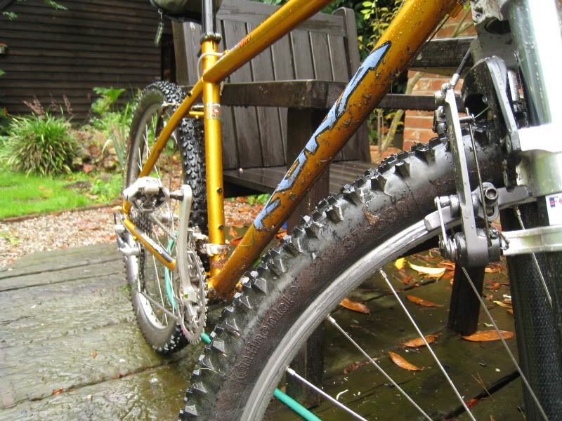

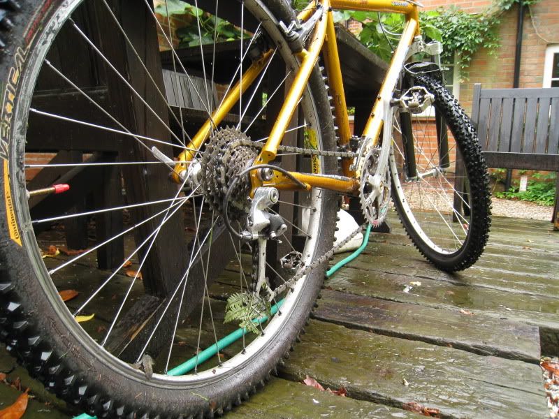

Swapped the XT cassette for a nice XTR M950 one, swapped the (unused!) XT Rapidfire shifters for some XTR M951's and swapped the RaceFace chainset and titanium BB (to sell, need some cash!) for the original Sugino Mighty 900 and UN-72 BB. Sorry pics are a bit 'indoor crap' :!: .....
I also tried some new black Onza HO's I aquired, but swapped them for my old ones to go for the ride. I'm a bit undecided as to whether to use them or not :? ....
I'd been desperate to take it for blast for ages and decided to get out today. I obviously got very wet and rather muddy, but it was an excellent, fun ride :D Really different to the Superlight, it seemed to be 'egging' me on 8)
Must fit a crud catcher :wink: ...
Went through quite a bit of fern, some stuck!...
Cheers

XTR chainset and BB is now on my Superlight as it has other XTR kit on. so much chopping and changing!
Slightly off topic...
I suppose I could look for silver rings for the Raceface cranks or a compact drive middleburn set-up (would give lower ratios as well 42/32/22) at the moment they are 46/36/24 on the RS1/2 cranks.
I think as the Middleburn cranks aren't compact drive I would need a BB with a longer axel to allow correct set-up and chainring clearance. I'll see if they have any info. on their website.

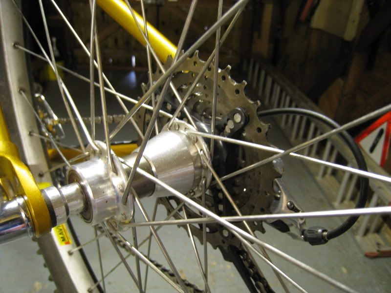

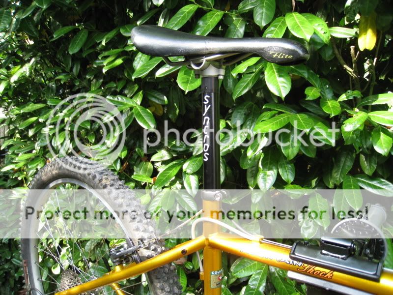

Up-date 8th August '09
Right, XTR chainset and BB back in situ :wink: M950 rear mech installed and the finishing touches of new Syncros decals (cheers Gil) on the seat post and a set of very nice Hadley Racing titanium skewers 8) slotted in.
More or less done now I think :shock:
Thanks for looking and all the comments :)
Cheers
wad
