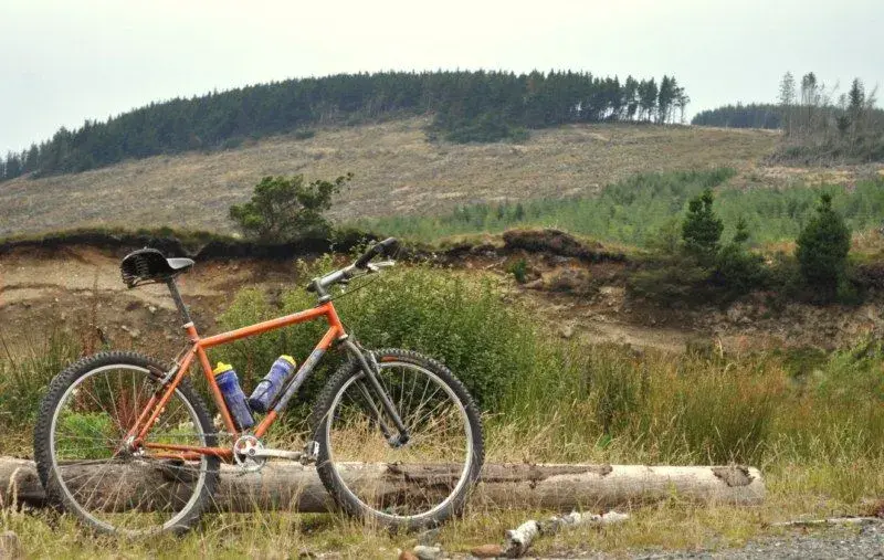

The Kona did attract quite a bit of attention during the course of the weekend both during the race and at the campsite.
One particular guy had cycled over from Swansea on his later 90's single-speeded Kona carrying his gear & tent on a carrier which he removed for the race. He was trying to scrounge a lift back to Rosslare ferry port when he ambled over for a look.
Quite a few cheers of "KONA" during the race, indicative of the respect or fondness many seem to have for these bikes.

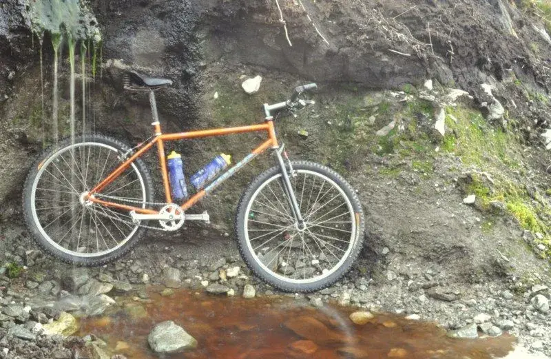

I had tweaked the old rear XT derailer but couldn't eliminate the chain jumping when giving her some stick. Eventually I chucked the derailer and just shortened the chain as much as possible, problem solved.
No more slippage and the chain only came off twice but, in fairness, this was only when I was walking the bike up hills.
I may have a closer look at the flywheel and apply some fresh oil to the pawels as the cranks tend to spin while the bike is walked.
Nothing I'd be concerned about, in fact I was happy enough as on both occasions I had the assistance of a couple Canadian lassies whom I'd been "unable" to get past.
Currently its running 32/18. I'd gotten 14, 16 & 18 tooth cogs to play about with but with me only getting back into cycling I went with the easy option.
It was more than enough for all assents encountered with only the engine behind the bike necessitating an ocassional walk uphill.
The only time it was undergeared was on one particularly steep decent during which the brakes were firmly applied so again more is currently not required.
Again the limiting factor being yours truly.

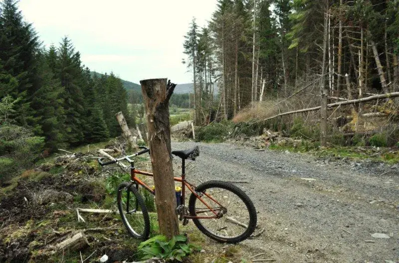

Originally the plan was to carry out a basic clean up of the bike & up rate the transmission components.
The reason behind the single-speed conversion was simply to facilitate me entering the race and taking part in the festival but having used it both over the race weekend and afterwards I'm well on the way to being a covert and leaving the gears for the road & touring bikes.
