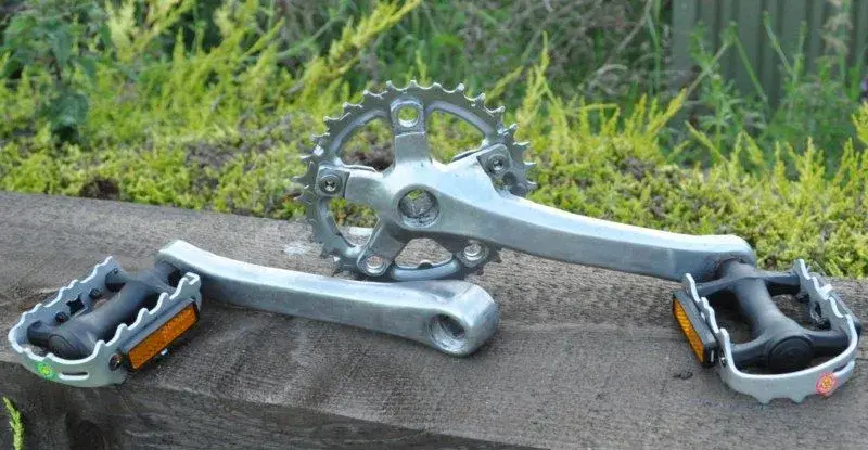

The bottom bracket was not too bad but there was some coarseness in its movement so a suitable cartridge Shimano BB was sourced from the LBS which'll be popped in soon.
The original pedals were creaking away so into the bin they went. I sourced some El Cheapo replacement pedals from the LBS. Once the crank-arms were given the spit & polish treatment they were introduced to each other and seem to be getting along fine so far.
I might however replace these with the Shimano clipless SPD pedals of one of my other bikes so I can use my shoes for the actual competition.
Very little wear on the chain-ring so, once given a good soak & clean in diesel, back on it goes.

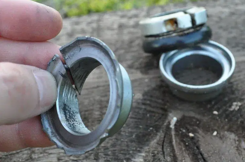

Only real hiccup encountered so far was during the removal of the head-set.
While the other hex-head screws in the frame, bottle cage & carrier/rack mounting screws, were fairly corroded they came out surprisingly easily.
I'd been generously soaking everything in WD-40 since acquiring the bike and this combined with the quality of the original components helped, I'm sure, in shifting them.
Unfortunately the smaller diameter screw found within the head-set lock-ring sheared when I was trying to gently tease it out.
With the lock-ring encouraged off I then found the head-set cup refusing to shift.
Many applications of WD-40 over three or four days with as many frustrating attempts to walk the thing out all came to nothing.
Finally after wasting loads of time and losing the rag I revved up the Dremel and cut a slot in the collar of the cup weakening it sufficiently for it to snap under pressure.
As requested above, can anyone recommend a suitable replacement please?

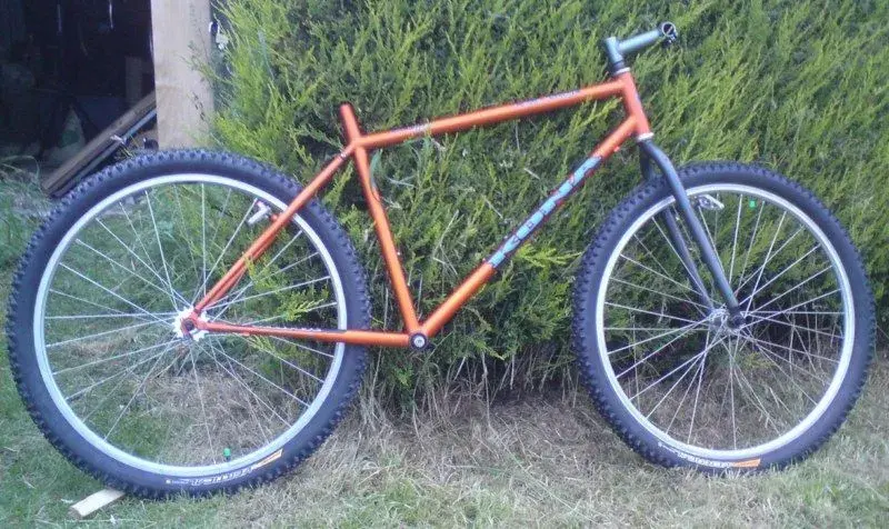

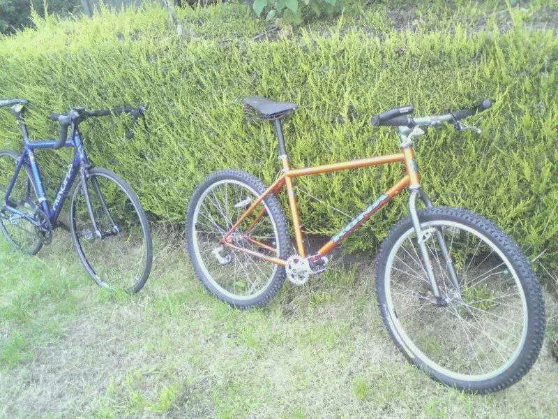

Bit of progress with the various parts arriving today.
Nice to be able to retire to the shed knowing that all the parts needed were at hand, well nearly all.
Few nuts & bolts still required which I'll source tomorrow and adjust the brakes.
Hopefully that'll allow me to use Weds & Thursday to do a couple of shake down rides before loading her into the van and heading South for the single-speed event on Saturday.
That hedge might even get cut before I go though thats unlikely.
Proper details to follow when time allows.
Thanks for the positive comments guys!
