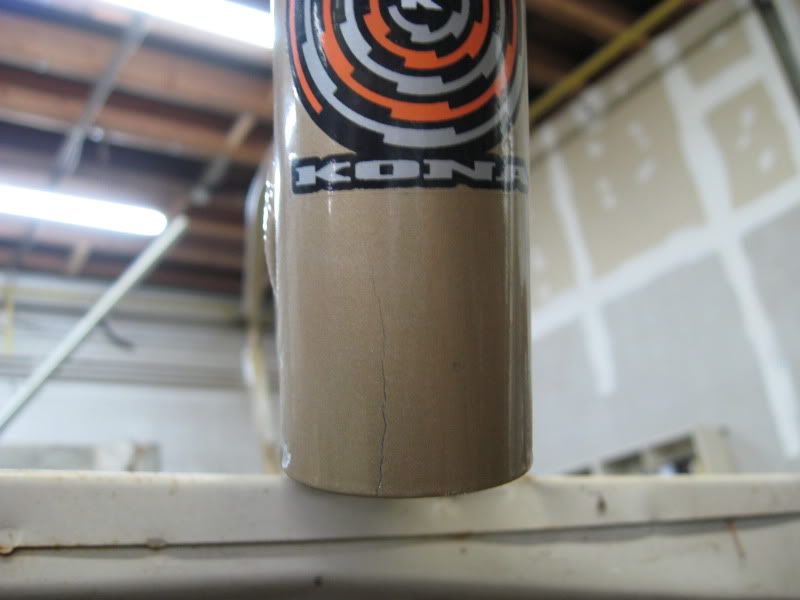

Damn shame. Same circumstances with my Kula. Bought it, got home, started stripping it and there it was. A big ol crack.
My '94 Kula cracked in exactly the same place,it made one hell of a bang when it did :?
I sent it to a frame builder somewhere "oop north" and he replaced the head tube and gave it a respray (this was in about '96).
I rode it a few times but it never felt "right" so i sold it to some bloke in Finland :)
My understanding is that replacing the head tube on an aluminium frame isn't really a viable option, especially as the overall cost would well exceed the value of the frame. I feel sure I've heard of people getting away with having the crack closed, rewelded and externally reinforced though. Presumably a steel band outside, if there's room below the down tube. Needn't be too unsightly, and could give some more years of life.

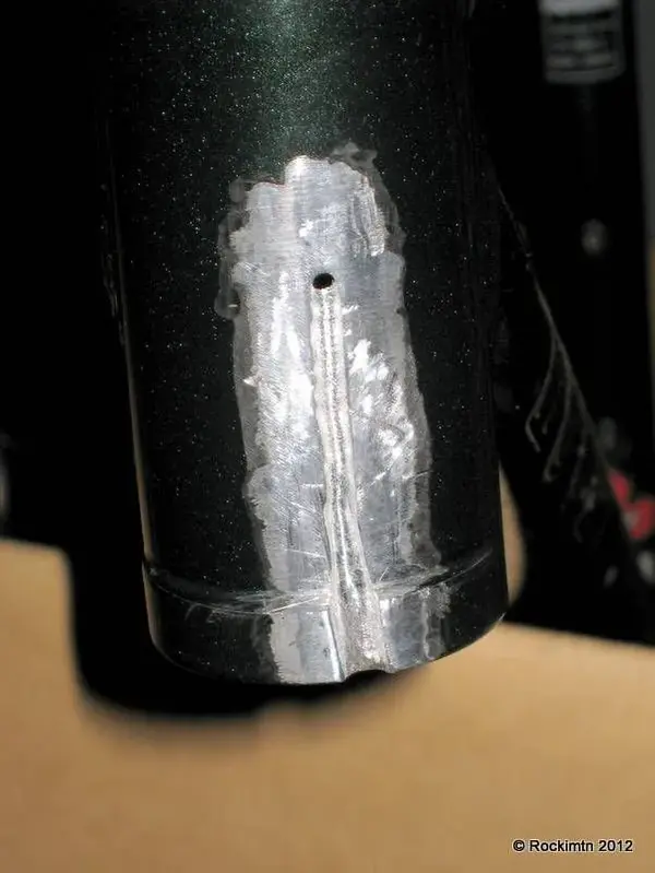

let's see how this goes ;)
thanks goes to trail_head for the assist in the pre-weld prep work. :)
