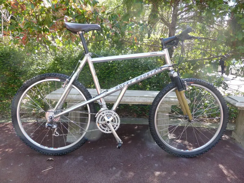

'94, erm '92..., well '93 Rocky Mountain Cirrus rebuild

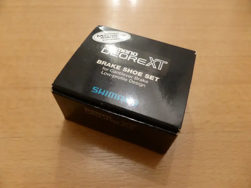

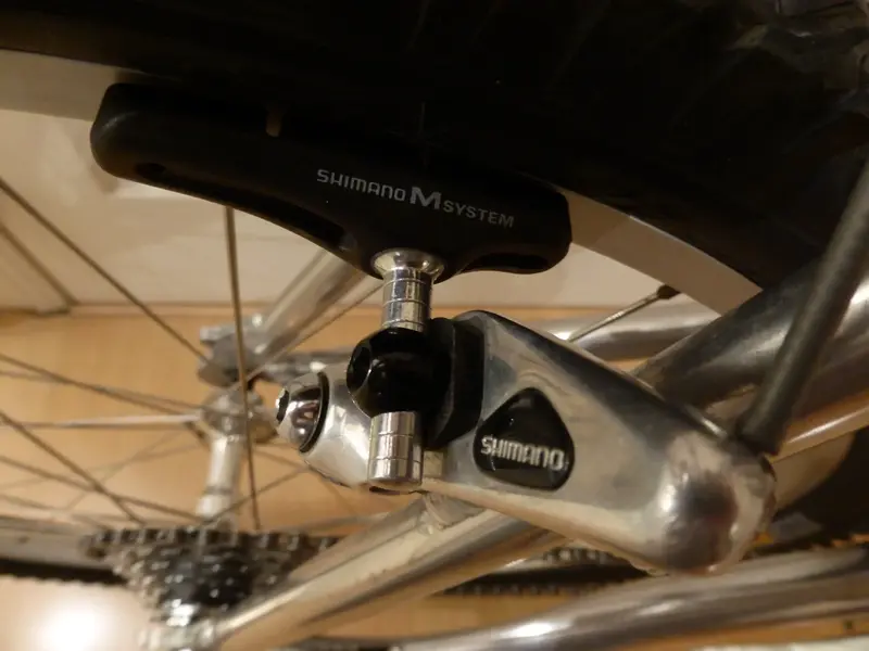

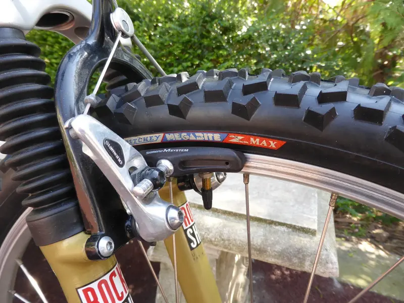

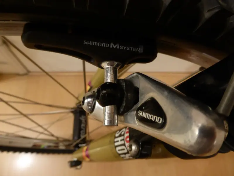

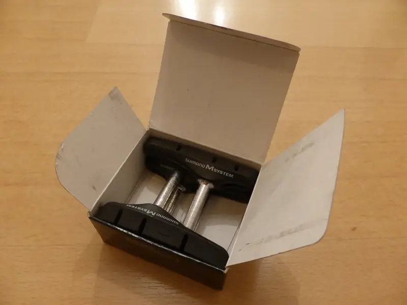

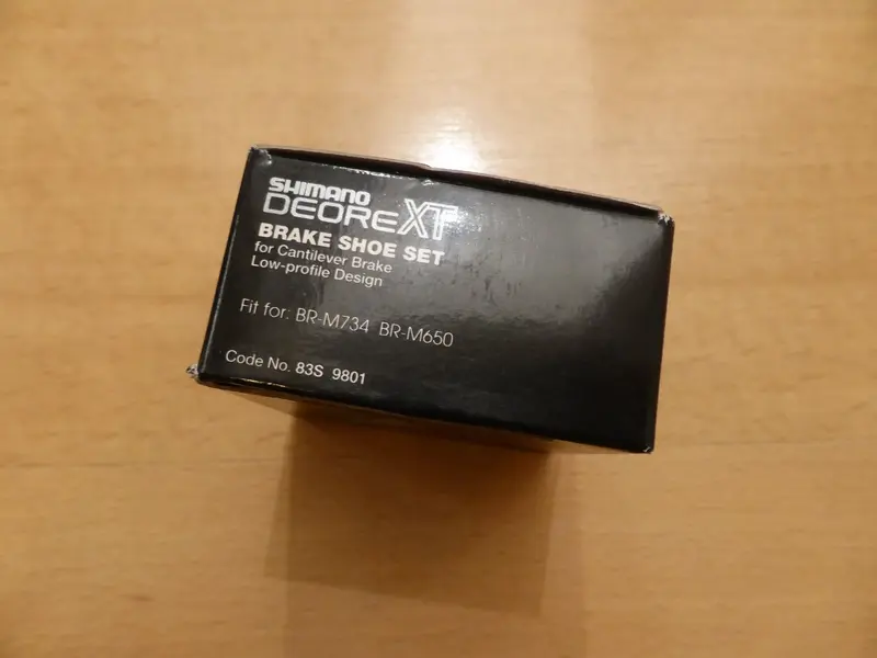

So it turns out that my BR-M734 brakeset didn't came with the right shoes. Fortunately, the correct Shimano Deore XT M System brake shoes can still be obtained NOS nowadays :)
Discrepancy fixed!
foxb13:248751sl said:

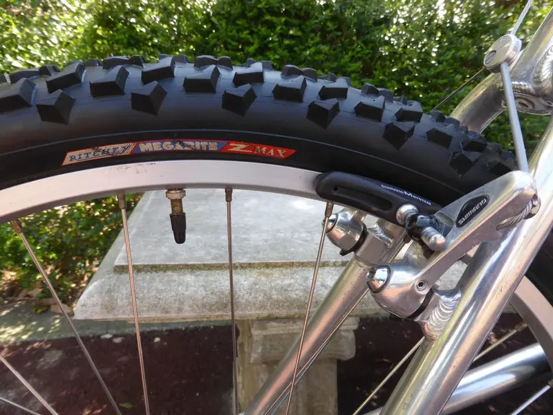

..., but finding runnable blackwall Ritchey Megabite Z-Max tires as fitted on most '93 Rocky Mountain bikes is unobtainium.
Sorted. And at a bargain price :)

For you all blackwall haters, my Cirrus now sports a pair of skinwall tires ;)
Well, it's just that Panaracer Smoke/Dart Classic re-issues are more rideable on tracks than my NOS Z-Max, which I'll put on for exhibitions only :cool:

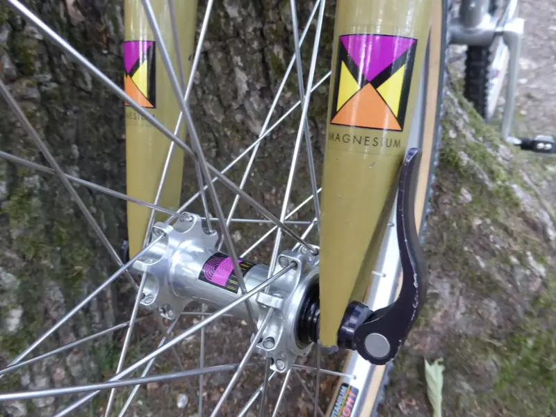

I've later discovered that this Syncros Hardcore hub was in fact introduced in 1994, so slightly off by one year from my plans. In retrospect, I even could have gone with a Shimano Parallax hub that was marketed the same year!

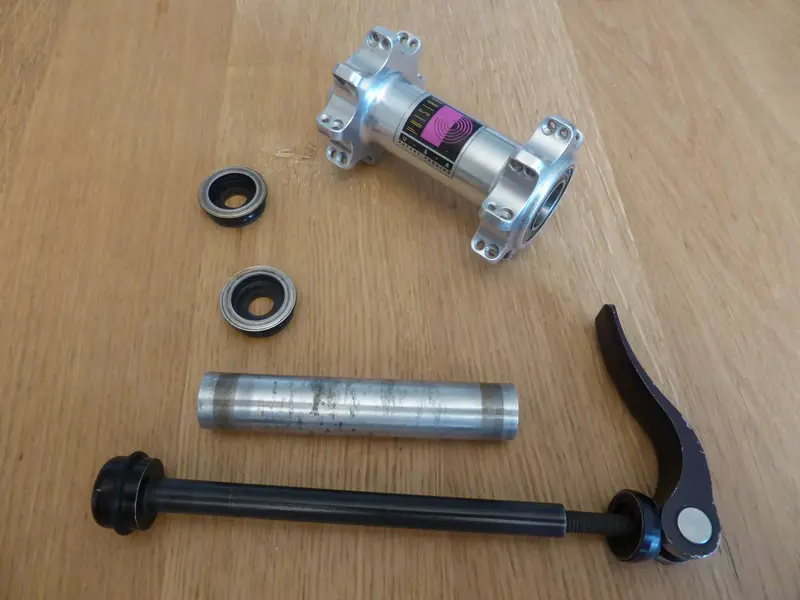

Sorted! I don't exactly know when this Pulstar Mombo front suspension hub entered the market, but I own a MTB from 1992 that came originally equipped with Pulstar hubs, the hub shell and Pulstar logo being exactly the same than this suspension model.
Beyond the X-design to accommodate for straight spokes, the Pulstar suspension hub sports an oversize 17mm axle, incorporating the QR skewer.
As outlined in its March 1994 issue, MBUK was apparently not convinced with such an approach [1]. I didn't notice anything wrong on my side, but yes, the action to actuate the QR is quite harsh. Anyway, I find that the Pulstar logo nicely matches the color scheme of the Mag 21 logo/forks :)

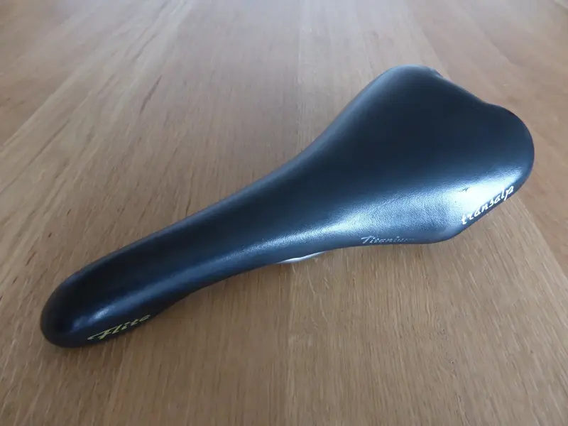

The original Velo-made saddle with Shoulder Holder was found in the UK in a Rocky Mountain garage lot also including Rocky Mountain-branded stem, handlebar and seatpost in 30.4mm, so probably coming from an Expérience MTB. The leather of the saddle didn't have any bad scuffs nor scratches, but was probably exposed for years to the lovely weather of Great Britain ;) I tried to do my best with shoe polish to restore it but it'll probably take another couple years of polishing to make it looks like as how it was manufactured in November 1991. If you know other restoration techniques, please let me know. Some day, I may replace it with something more high-end.

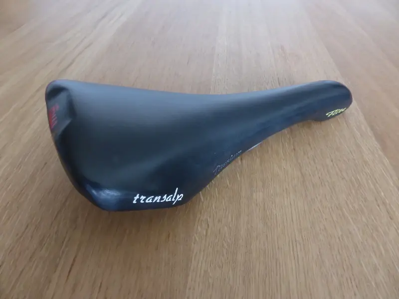

Now replaced with a (much) lighter and far better condition '93 Selle Italia Flite Transalp.
