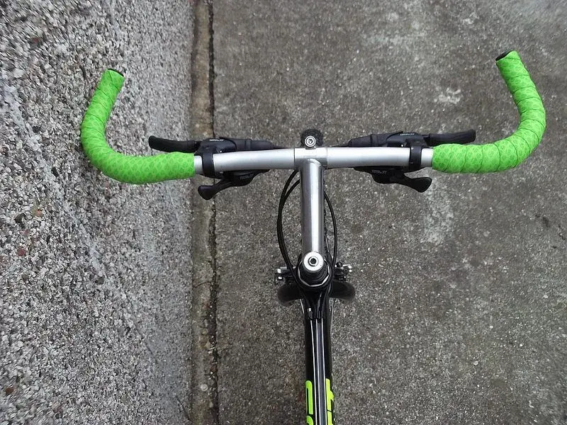

Not sure about colour of bar tape yet , or if I'm going to like the bars . Time will tell . The bar tape looked ok with the faded fluoro stickers , 'til I came across some new ones for the top tube and put them on , to replace the very tired looking originals . And yes , I did lacquer over them ! :roll:
I do have a pair of nice Ritchey flat bars on their way to me , so they will go on if I don't like these . I've doubled the bar tape where grips would otherwise go , to give my old bones a bit more cushioning :oops:
Full bikes worth of tat ! Wearing a Flite for now , but I do have a Ritchey Vector Plus Rail on the way , which may well go on instead .

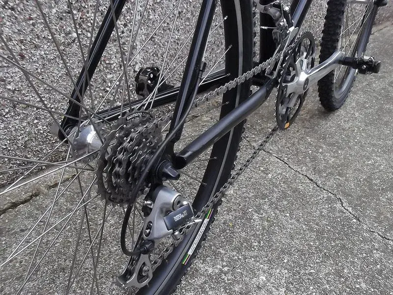

Also making an anti chain suck thingy out of some aluminium I have knocking about . My other Scott frame came with one , so I've just used that one as a template for this bike .
So just a possible saddle swap , and to try these weird looking bars out , and it'll be finished . If I like them , I may see if I can find some fluoro bar tape instead of this bright green stuff .
Hope you like it boys and girls :wink:

Nice work Mike :)
While the bars aren't to my taste I think the tape looks great and adds a nice touch of colour to the bike.
Re: '93 Scott Pro Racing , updated 16th June
Looks brand new. Love it. Bars look brilliant with the green tape.
Cheers Adrian :wink:
They match the transfers ok , but for the new top tube ones . :roll: Hoping they will fade nicely
Mike
Finished now with the Ritchey saddle :wink: ,
Here's a couple of pics , got used to the bars , give a nice flat position , and feels good with the different saddle too .

skolioza":3k83f242 said:
Looks preety good Mike!
Cheers Marcin , the cable hanger isn't moving now I've taken the washer out from above it . But ive got a back up plan now mate :wink:
