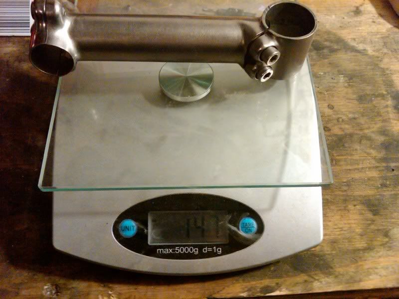

I beleive the specialised Ti stems are around 180g too?
My 150mm is 148g
that's really light! in the WW section on here and on the weightweenies site people measured between 160 and 170 grams for 135 mm ones. Maybee difference between the matt version and the polished one?
EDIT: I knew I read somewhere that specialized mentioned a 179 gram weight for this stem. It's in the '95 s-works catalogue (with the Steel frameset description, but isn't that the same stem for all the different frames?)
Re: Weight
Think that's where I read it. Like I said, very few sub 170g stems out there.
