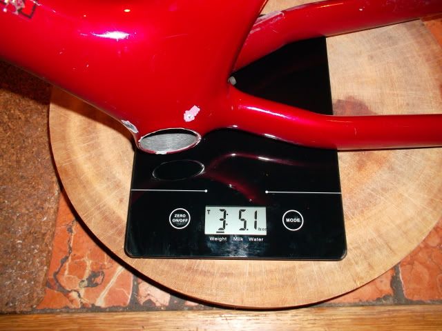

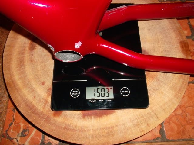

So, Frame weights:
Bare, with seat clamp.

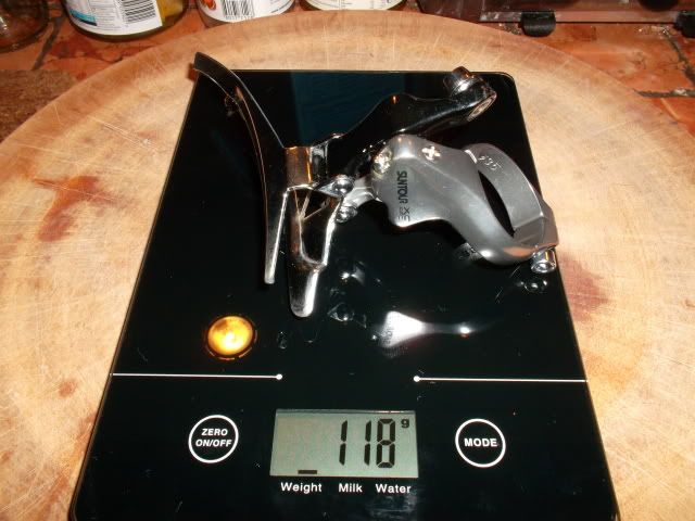

NOS 35.0 XC pro Front mech:
These will be accompanied by my MOS (My old stock) XC Pro thumbies.

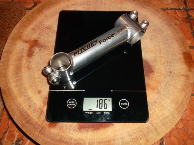

NOS Ritchey Forcelite stem:
not exactly setting the world on fire with the stem, but it's quite light for a retro stem!
ameybrook":399c0g9g said:
Sorry to be a buzzkill, but that's a pretty heavy frame as a the foundation of a sub-20 lb bike.
My old Epic Ultimate was 1300g and this complete bike with rigid DD fork was still 21lb.
Yeah, Like I said, I was told it'd be optimistic! Doesn't bother me really, I just like to have an idea of where I'm going with it really.
