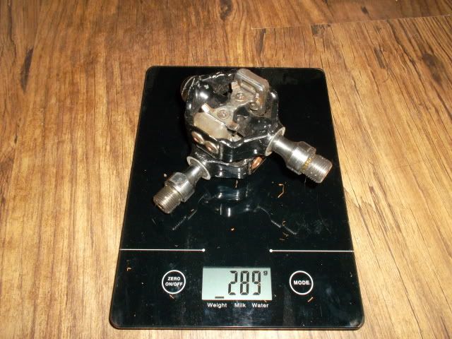

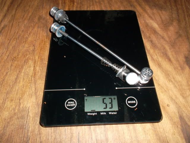

Right, small update, pedals and skewers:
Couldn't face controltech skewers, as I often have to take my wheels off.

great stuff! looking forward to the complete build/weight. Those pedals are very nice too. Never owned them, maybee I will buy a set to try them myself... :wink:
Thanks for the kind words guys.
If you ever want a set of onzas, make sure you can get cleats first! I love them; nice and simple, just like me.
:shock:

Allthough I love the Onza pedals, aren't speedplays (magnum titanium)even lighter? Maybee they were a bit later though? No idea of availability either...
