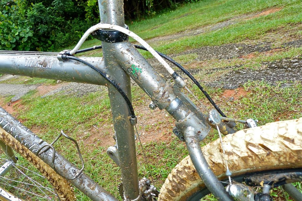

Those brakes should be fine if you shorten the straddle cable, move the pads up a little on the canti arms and inboard on the posts. That should help wheel removal, too. Kool-Stop's pads should give you easier adjustments, decent power in the wet, and more clearance for wheel removal.

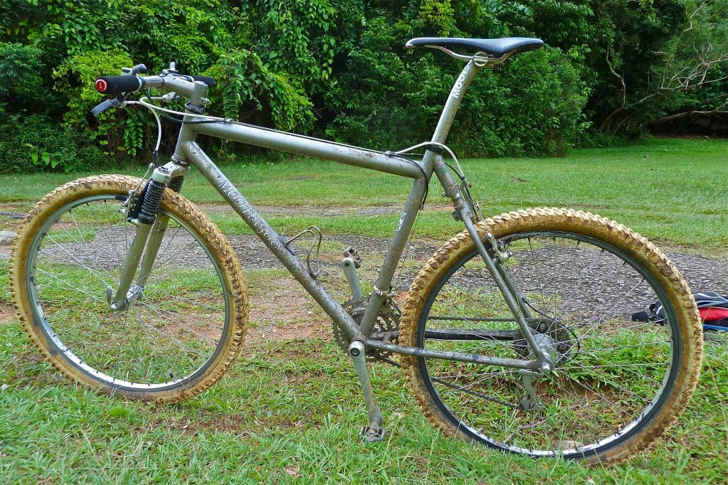

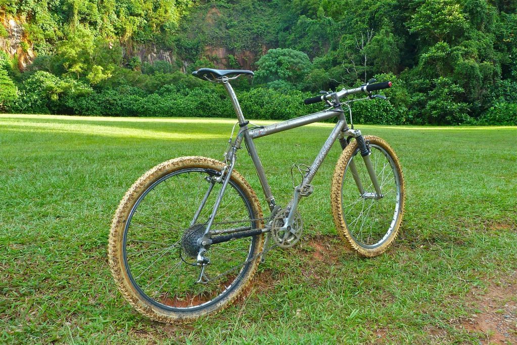

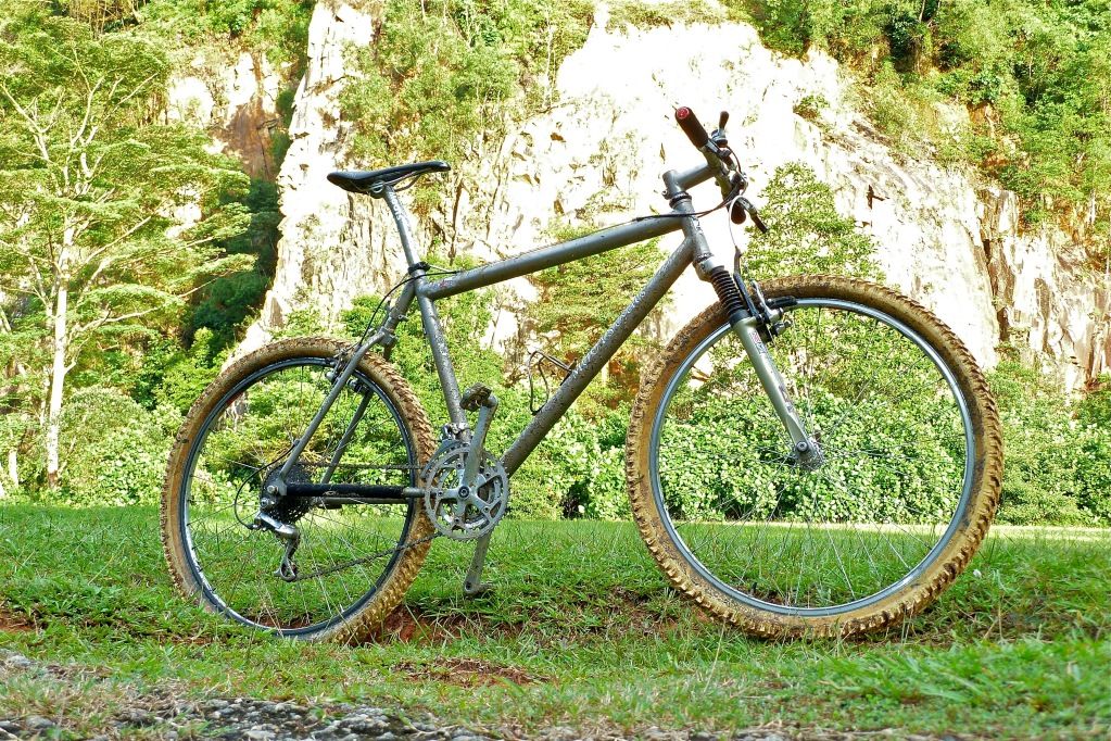

It's my 2nd time in a week and I am really proud of this bike. It handles well, climbs well and it goes down really quick as well. The last bike which I had fond memories of was my Cannondale Beast of the East. It seems, this is the next one!
As semi-school was pointed out, the rear bobs quite a bit. And it is especially obvious when you're on the road. Once off-road, it really smoothens out the ride.

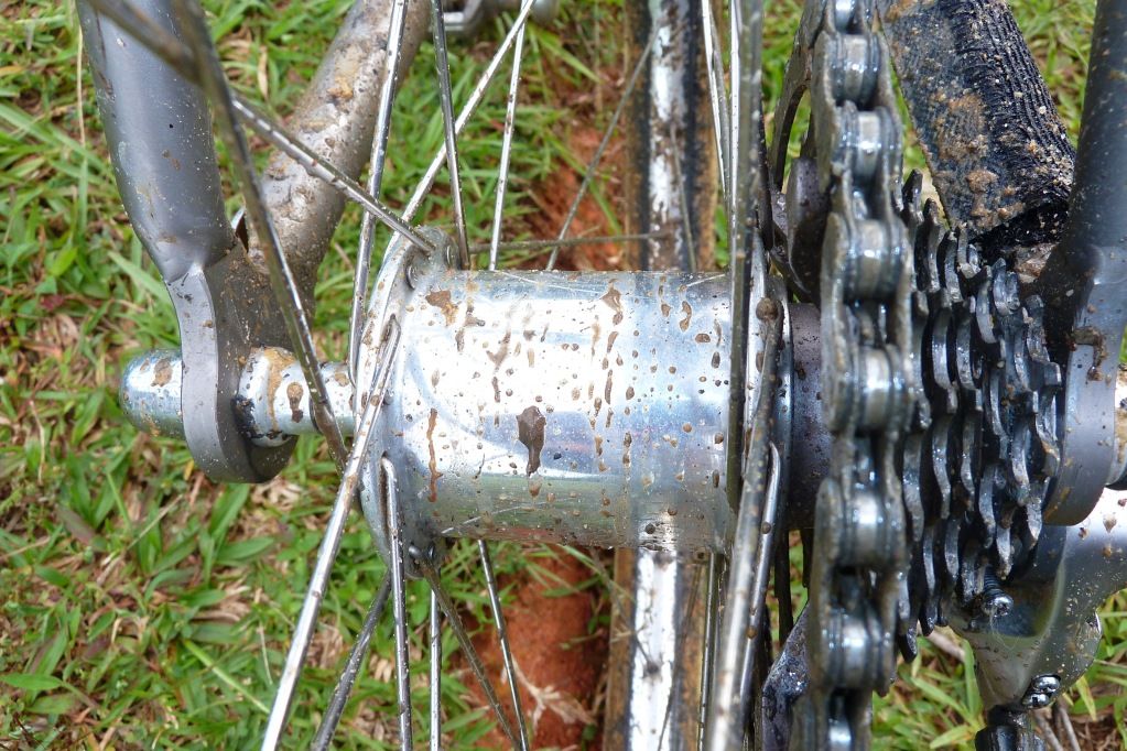

As you might have already realized, the wheels and tires are different. I've managed to acquire a set of White Industry Araya wheels from sidekick and also fitted my old Panaracer Magic, which I had transfered from my Klein Adroit for trashing. The brakes have also been changed out to my M900 cantis for ease of usage. Unfortunately, the brake pads are drying up so I'll have to hunt around for replacements. Anyway knows where to get the Koolstop ones???

Very nice scenery and bike you have there!
The YBB has always been on top of my most wanted list so far!
The only thing i'm curious about is the brake setup, aren't the Paul levers for V-Brakes? I think you would have better stopping power using the Paul Canti-Levers. Im curious because I have planned a mix of Paul canti and V-Brakes for another project.

Thanks man! I appreciate it. I'm glad you're a YBB fan too!
Anyway, I just digged into my parts bin and fitted whatever that was decent onto the MOOTS. So to be honest, I have not paid much attention to the compatibility issues as it seems to work perfectly fine. To testify to that, I have been going off-road for a few times now and it has served me really well!
