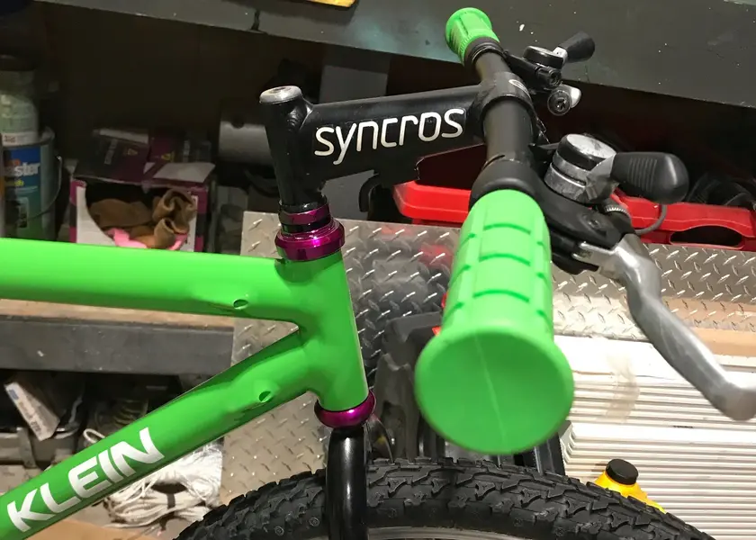

I’m throwing this out there hoping someone can help, I’m looking for a black 1” threaded headset. Would prefer XT but would entertain something else. The Chrome FSA I have won’t look correct on this build. Thanks

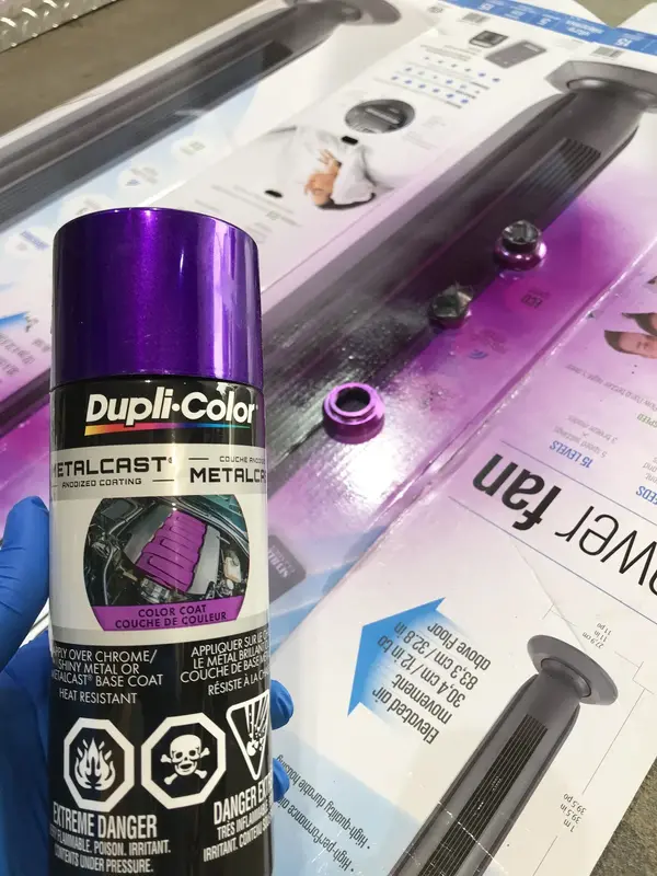

So the chrome headset i have won’t look right on this build and payment $150 for a black Deore XT is not happening either I decoded to try the Duplicolor paint option. Unbelievable how this turned out. Will try it until another option presents itself 304C82A7-F384-48CA-AD6D-5DA632561D20.webp
That andodising aerosol looks mint... great job. I've looked at similar on ebay but always imagined it would be crap.

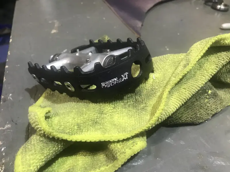

how do you plan to fill the engraving? i have a pair of DX pedals awaiting restoration and have been wondering how to do thios
Ya anodizing spray turned out fab. Two very light coats from distance then a heavier one. It does run easy so care to move quickly. Engravings will be filled using a laquer stick also called fill stick. Haven’t done it yet so can’t report on it yet.
