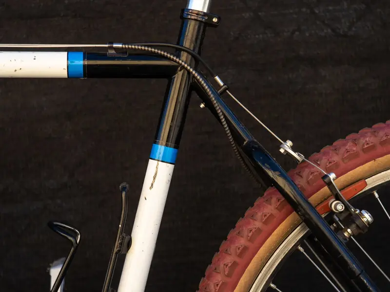

The deer head shifters weren't working for me. They shifted fine though after shifting to lower gears I'd take my hand off the shifter and the tension from the 952 rear mech would pull the chain back to the tallest gear so I was having to hold my thumb on the shifter to climb. Rather than try and figure out what was wrong I decided they were too chunky and swapped them for the XC pro thumbies that are working great.
Still a work in progress. There is a frightening front fork jitter that I don't know the cause of. I raised the straddle cable and it maybe helped a little. I still need a pulley and a front mech and everything needs to be dialed and the cables trimmed.
At the very least I want to switch the chain and dust caps for silver which is what I initially wanted but the crank seller shipped the wrong color and my buddy lent me the chain while mine was still in transit. Maybe a black seatpost. Halfway toying with the idea of putting an XC Pro group on it but everything on it is really nice and works great so I think I'll just enjoy it like this for now.

Echoing other comments, I also ran a set of 987's on these forks and they flexed like crazy. My current OR has a P2 fork and feels much better up front :)
Hopefully I can work out a way to make the flex manageable, can't bear the thought of separating the frame from the fork.
I would try a brake stiffener arch and see if the jitter goes away.
There was a Gorilla booster on there when I got it, I should dig that up and give it shot
And I can confirm first hand that that fork chatter is the most frightening of any bike I've ever ridden!
It's pretty gnarly
I would definitely make sure that headset is airtight, the stem too, and all the bolts on the Composite crown.

Anyway, definitely get that roller and a front mech on, that 2x9 setup working and all those cable ends shortened up! ;)
been swapping by hand ;D big ring gearing works on the flats but as soon as the climb / trails start I gotta move down. But yes, I need to get the remaining parts stash with my front mech from my buddy.

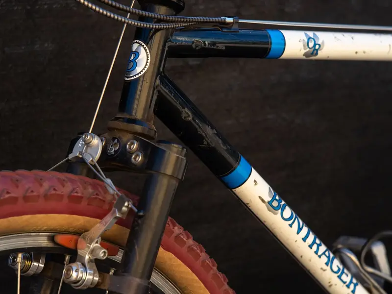

Some hallmarks of an early OR -
This bike predates the XS, S, M, L etc sizing
Flat top tube / brazed on rear stop with a pump peg below.
-Before the "B" logo dropped the cog around the paw which is a mountain lion paw

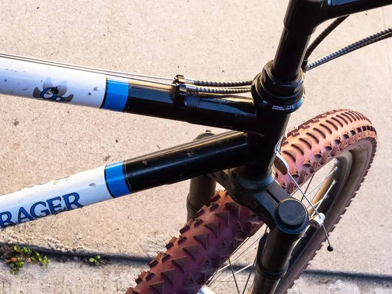

-Head tube - "Keith always raised the down tube junction, in order to get the portion of the head tube that holds the lower head set cup away from the heat affected area. This preserved hoop strength of the tube to prevent it being ovalized by the loads put on it by the head set cup..." quote from Tom Clark
-Hand made gussets - cut from the TT 4130 frame tubes before they started ordering them laser cut and ready to weld.
"You can spot them because they were longer and where the half moon is cut into them to break up the weld zone, it looks like it was cut with a carbide bur in a hand grinder and the two sides probably don't match exactly. We simply cut top and down tube remnants into lengths and then split each one into two with a diagonal saw cut and then cut the weld reliefs and deburred them with a carbide bur. The later ones we're much more refined as they were laser cut out of flat sheet and then stamped into a round profile in our stamping machine." - Tom Clark
Early or late, they're there to make the joint behave as if you didn't lose any of the strength normally lost with welding. Scalloped areas left un welded on the sides and the one end so there is less heat affected area thus making the gussets more effective.
-Bonded & riveted aluminum cable guides - "Our bonded and riveted cable guides allow us to install these parts without heating the tubes. It is not very clever to make ultra strong main triangle joints only to weaken the tubes just behind these joins with braze ons. My tests show that braze ons near the down tube or top tube joints weaken the frame. Our bonded parts don't." Quote from KB from ~90 Frameset manual
Later on, after Race / Race Lite designations, the Race guides were welded steel and the Race Lite bonded.

Any idea when that distinction stopped? My race lite was '94ish and had welded guides
