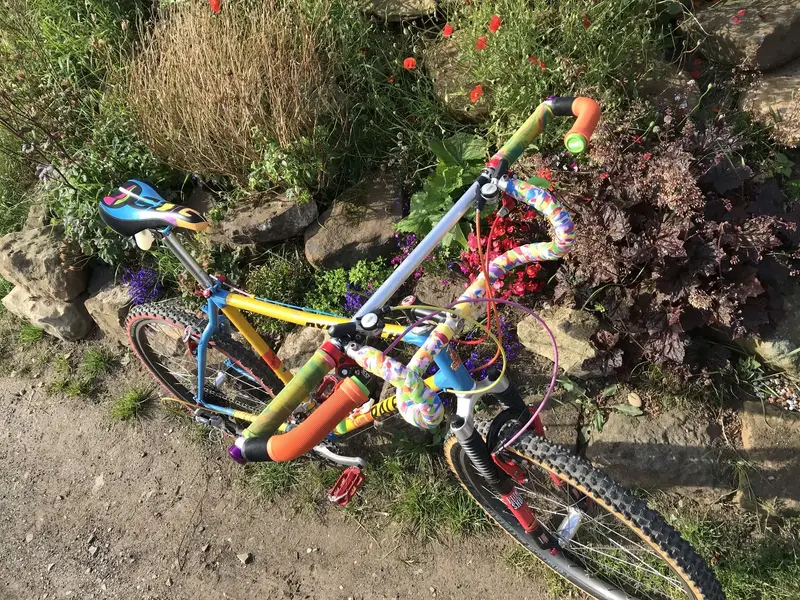

89 THM Raleigh Dyna-Technicolour
I can’t settle. The brevs are hateful. Dull. Depressing. I refuse to spend. I will cobble.

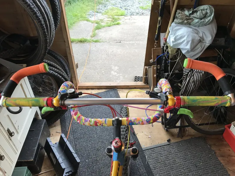

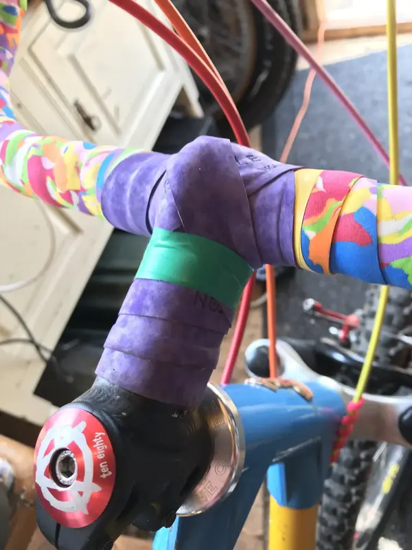

And that black Easton stem………
Swaddled I’d call it. In an old badminton racket grip. Much prettier now. Wimbledon tribute.
I just fitted it to accommodate the cockpit setup. Once everything is sorted and after a couple of rides I trim stuff. Just found some gold chain ring bolts!

Now also has period pump,{which was an issue given bent top tube) second bottle cage, coloured cable crimps and technicolour chainring bolts.
Needs new photos but i'm taking the boss to her sister's dahn sarf in sunny wiltshire today. for a week. So anything is possible at THM Towers for the next seven days.
