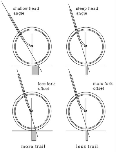

Wow, I’ve never seen a fork with so little trail as that. Look how much closer the front wheel is to the front of the chain rings now – you’ve reduced the wheelbase by like two inches or something, all coming off the trail.
actually you've made a common mistake, the forks look like they have less rake (fork offset) which will mean the hub is further behind the imaginary contact point of a line drawn through the headtube i.e. giving more trail which should actually result in more stability as its harder to get the wheel to turn away from its stable setting of pointing straight on.
Thanks, but why then did Kona have a greater amount of rake/offset on the P2s fitted to Hahannas and Fire Mountains than to higher models in the range? (1.74 vs 1.54) And why did Bontrager have special Rockshox forks made for his bikes with a rake/offset of only 1.25? Are you saying that a Hahanna has quicker steering than an Explosif and way quicker than a Bonty Race Lite?
Are we sure that more trail means slower steering, or could it be faster?

Very clever of you to find those words of wisdom! I don't think we're hijacking the thread. After all, my notion that the big offset/short trail on the 'beginners' bikes' in the Kona range was to make them less twitchy and easier to ride is bang in line with LeGrandeFromage's report that radically reducing the trail on this Specialized had made it very twitchy. [And I assume he meant on the way to the pub, as we can safely ignore whatever he thought about it on the way home.]
I don't pretend to understand about geometry either, but I did note that KB was talking about fast cornering, where you don't actually turn the handlebars, so maybe trail is less important. Another factor is that LeGrandeFromage hasn't changed the stem, so his weight through his hands is now 2.5" further forward in relation to the front axle and that may have almost as big an impact on how twitchy the bike feels as a few glasses of Squaddicott's Old Peculiar down at The Dog and Duck.
wider handlebars has added more leverage to the steering compensating for the dodgy forks.
